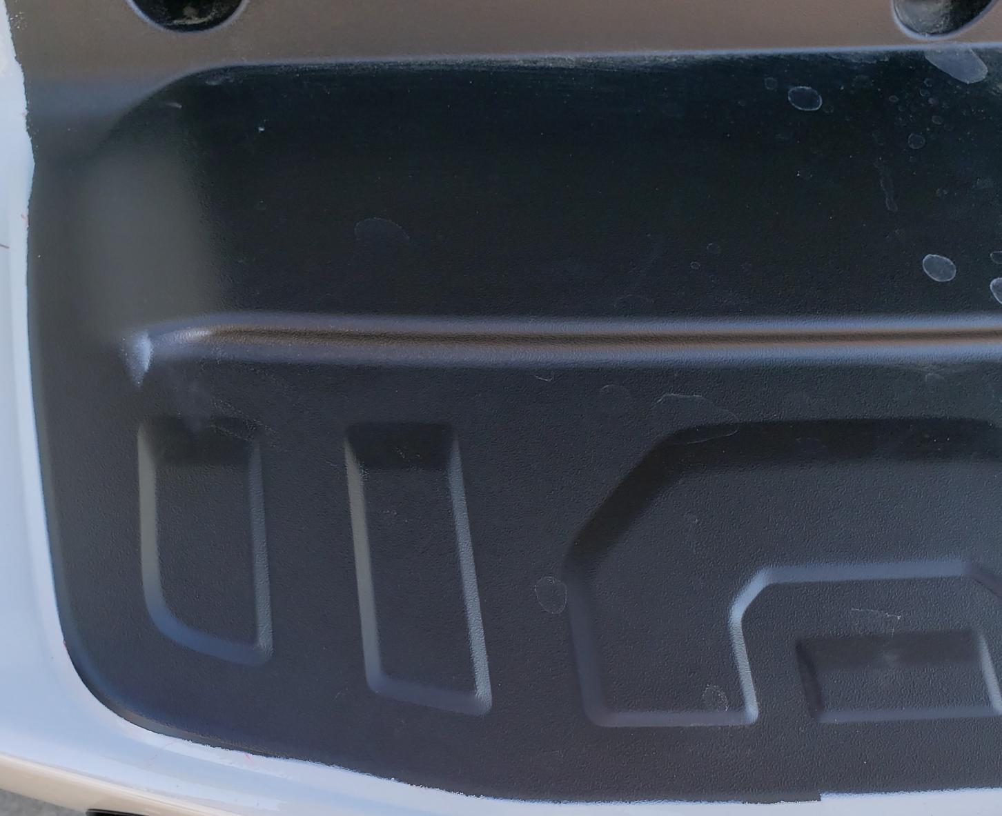

I don't believe the black step piece comes off. I am pretty sure (not 100%) that it comes with the bumper and is not removable. The lower black trim piece does come off, but they are not having an issue there. This picture was their first attempt and I immediatly rejected this.

Looking at the picture the are definitely not using fine line tape and they should not tape on the textured area you will never get a sharp line. Tape in the groove where it is smooth. Look at the original bumper you will see that's where the factory tapes there line. As an automotive painter I must agree this shop doesn't know what there doing.

I have to agree, this is getting absurd. The last two attempts were a bit better, but still noticable and not back to factory standards. I will give them one more look Monday and if not I will have them put it back together and find another shop.

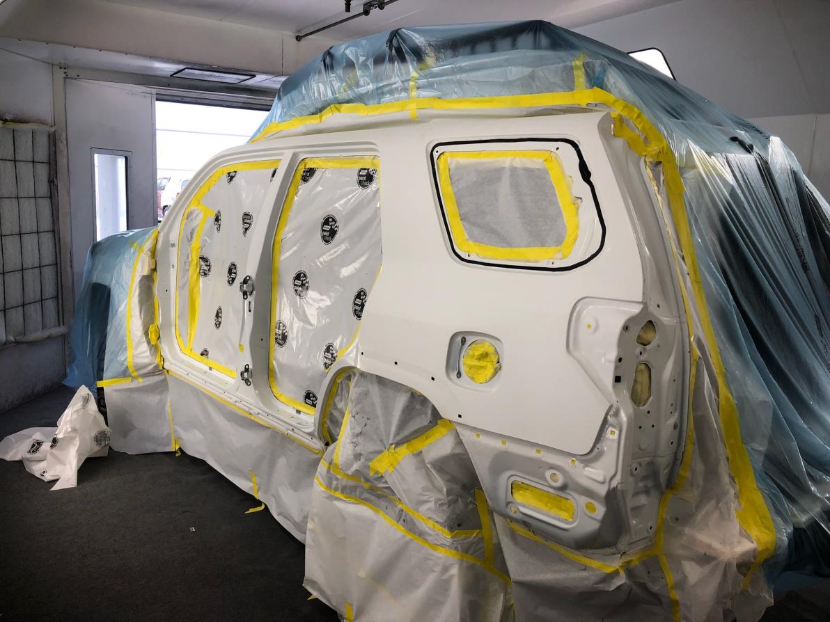

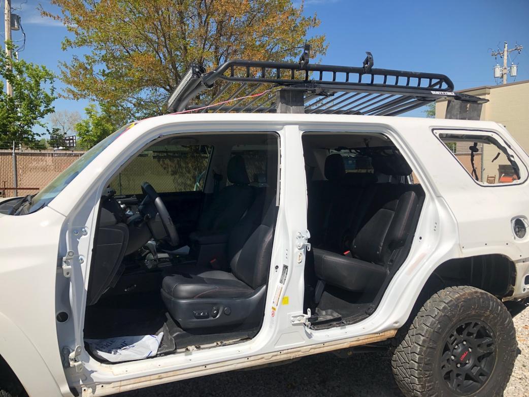

So I moved it to another body shop who were able to identify several more issues caused by Service King. It was the lowest quality body work I have ever seen. Luckily it will be fixed correctly and will be ready for trails and new pin stripes.
