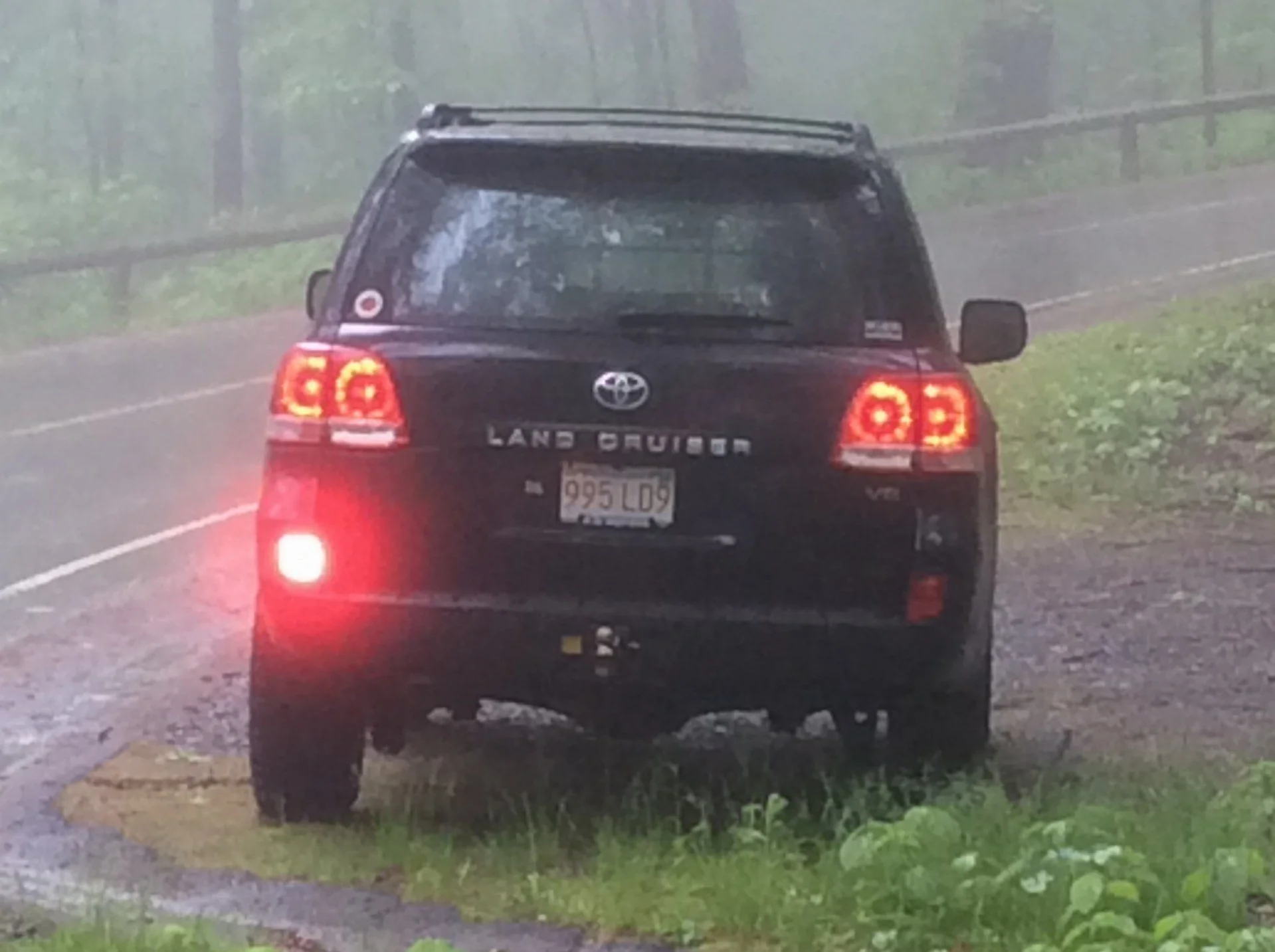

Rear fog lights are REQUIRED to be red. Same brightness as a rear brake light. Sometimes one light, sometimes a part. If it is a single, it needs to be located between the center and the driver's side of the vehicle.
Some examples:
img_1264-jpg.1467217
-Charlie

Hmm. Learn something new every day. :) those would just be parking lights in my state not fog lights. Explains the confusion. I believe the parking lights in this state have to not as bright as brake lights.
