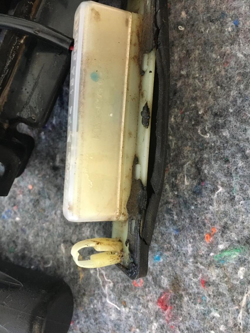

I added a bunch of pics at the end of this thread.
Removing rear hatch cover
I gotta disagree with [MENTION=464]clin9383[/MENTION] a bit, it was a pain to replace, no way would I be able to get it off with a 90° screwdriver. I had to remove the whole thing anyway since a few bolts worked their way loose on the fascia.

This was a problem with the 4th gens too. Had to replace mine in 10 years of ownership. Looks like Toyota is using the same cruddy part lol
If you are referring to the rubber part, I have linked below. It melts in heat due to people using sun block lotion or some other chemical that makes it deteriorate with the heat from the sun. You may have to clean it off with goo gone or something before putting the new one on. You may also need a 90 degree screw driver adapter to help with getting the screws off. Other wise, pretty easy fix.
Amazon.com: IE Works Rear Hatch Button w/ Screws Liftgate Switch Latch Cover Compatible with Toyota Prius Lexus 4runner Scion Camry Trunk Door Release w/Screws Repair Fix Kit Replacement: Automotive
X2 on this and this exactly what I have used to replace mine couple of year ago.
Using 90 degree screw driver will make replacement very easy (just two screws).
In my case, rubber part was melted by Insect Repellent spray with DEET… that spray will destroy plastic\rubber parts that are used on cars, boat, guns, etc.
