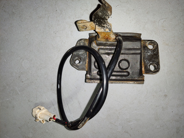

i found it!
it is in the latching mechanism, when i closed the latch manually with a screwdriver it turns the light off, and when i opened it with the handle it turned back on
maybe cleaning it out and stuff getting it moving freely would help, i know mine wont turn on somtimes either.

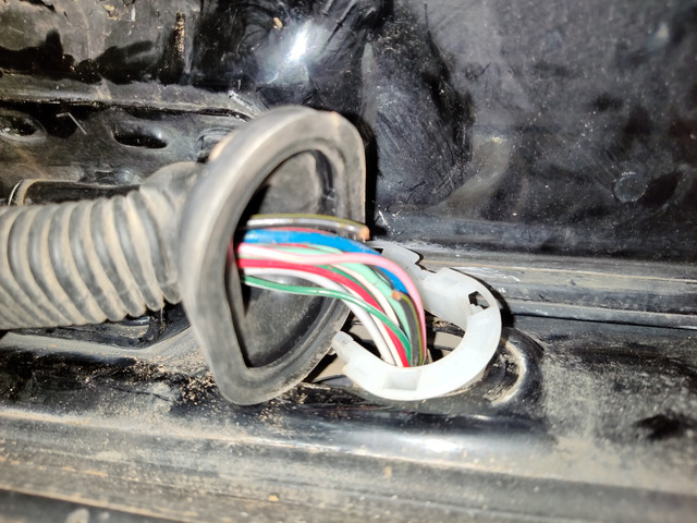

Yep, the switch to turn on the light when you open your tailgate is in the latch. Mine quit working, I took the latch off but could not get to the wiring inside because the assembly is riveted together. The latch is kind of expensive to buy just to fix the door light. For another possible issue, another thread on the topic mentioned checking the wiring in the rubber loom you can see by the tailgate hinge on the left side. I found a broken black wire and another wire with splitting when I checked.
