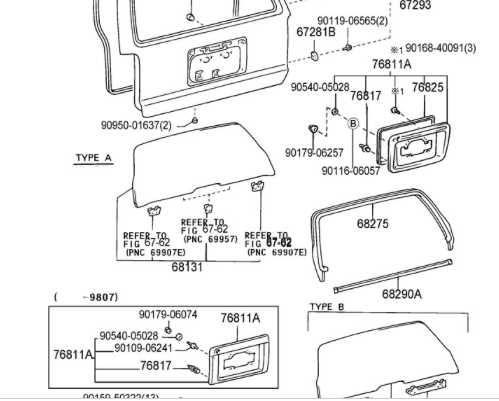

I attached the exploded view from the FSM, might help.
Thanks!

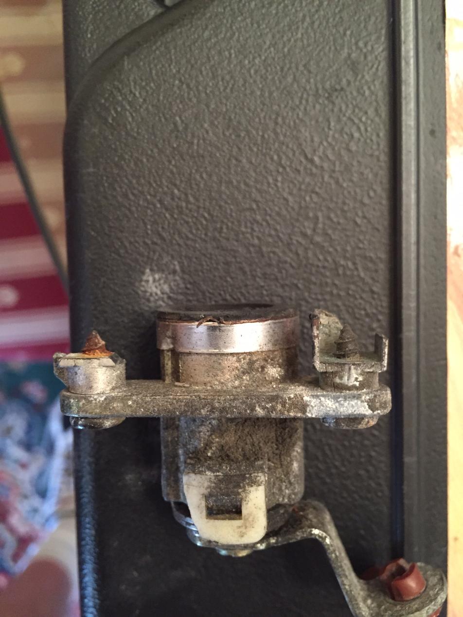

Finally opened up the hatch today and saw what was going on. There are two screws that hold the metal lock barrel in to the plastic license plate holder. The screws had come loose and unscrewed themselves somehow. I had to remove the plastic license plate holder to access the screw holes. In fact, when I pulled it apart, the screws fell to the ground.
I just screwed them back in & put everything back together. All good now.
Lucky break...the "screw holes" are still attached to the screws and lock core from mine. Furthermore, I have some damaged parts I have to replace because of the rear window being used which snapped plastic and cut wires. Congrats on the fix.

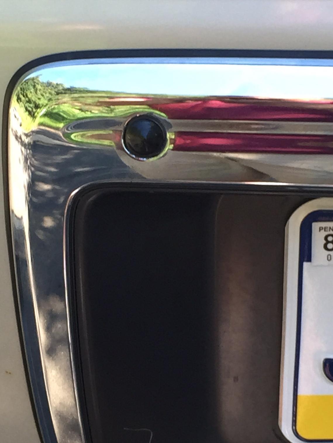

Key was missing, clunking in trunk. Followed your great instructions and tore the tailgate apart this morning. Found the lock cylinder but the metal ears were all torn off. There was no way to salvage it and I never have a need for the rear key. Miraculously, while fishing around in the tailgate I found this perfect black "nipple". I pushed it in the hole with some JB weld and we will see how she does. Looks factory.
Here was the key -
Not one of Toyota's finer designs on this bullet proof car. Small cast iron or aluminum ears on a device like this that gets constant use is never a good idea.
Back door garnish 76811A
I have the same issue, Key barrel fell off because of broken bracket.
Just to confirm, its part # 76811A ?
And my current Garnish is chrome, I'm looking to get the Dark Grey/Blackish color. Anyone exact part number?
Any help greatly appreciated. Thank you

Sorry for tha late reply. This just happened to my '99 4Runner. The inside mount for the key tumbler is part of the license plate holder, which on my truck has the dark grey plastic that matches the body moulding. Unless you want to do a half-a** job of repair you need to buy the license frame which was hugely expensive. The good news is that the frame is brand new as the old one had peeling paint. Bite the bullet and do it right. Before I bought my '99 I looked at dozens of 4Runners that all suffered from shade tree mechanic fixes. Just sad how many people don't fix things correctly. Glue and electrical tape was the choice in many trucks I looked at.
I've got to do the same thing to mine. Did the whole license plate garnish work - part #76811A? Thought I would ask before I ordered one.
Thank you.
