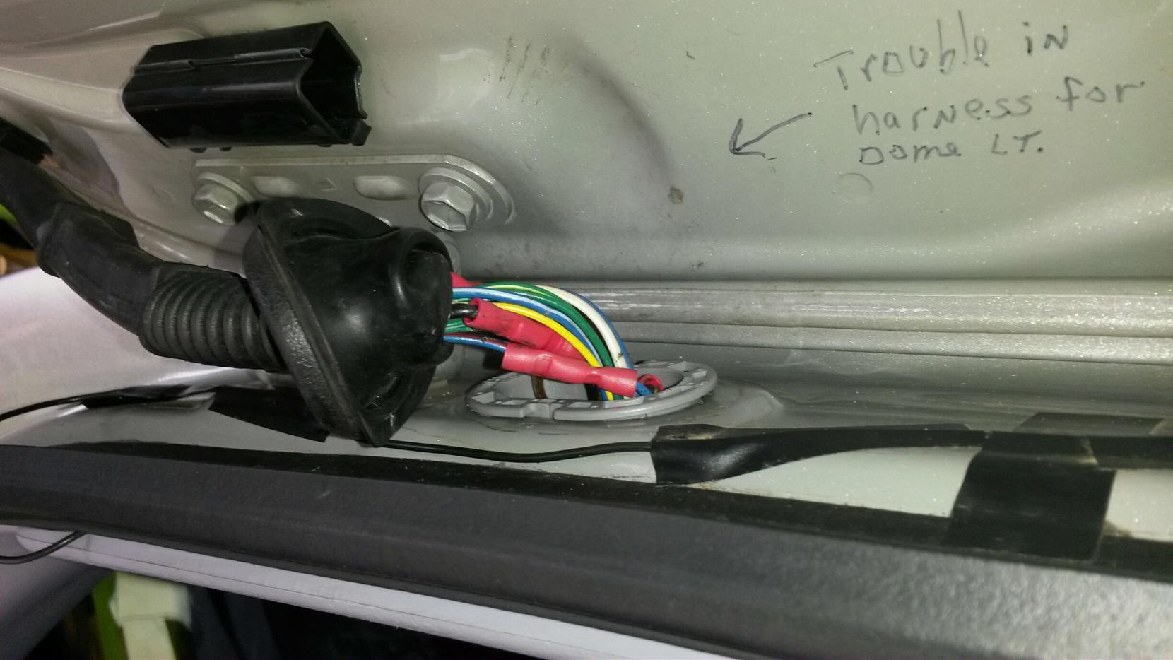

20150720_111135_resized.jpgFunny Neal you should say that! Guess what I found to be the problem to my rear hatch lock not working electrically? Broken wire, to be exact, the Black with Yellow wire going to the lock motor. Just happened to tug on it and wham-o. Spliced it...works great.
