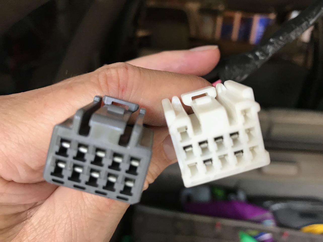

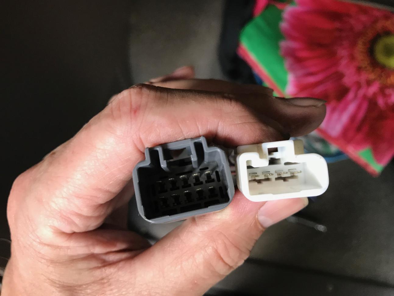

Tailgate swap - 99 to 96
I have a similar problem - I have a 1996 4Runner that has a badly rusted tailgate and I was able to pick up what I thought was going to be a compatible 1999 tailgate from a scrap yard. I started to remove my old tailgate and noticed that the harness that's up behind the headliner has two plugs one grey and one white. The grey plugs are the same shape and fit whereas the white plugs are different. I have two questions: 1) Are the grey plugs wired identically so that all I have to do is just plug it in on the 99 tailgate? 2) Has anyone tried to wire a short cable to transition between the two harnesses and make them compatible? I have both ends of the white plug from the 1999 and the plug in my 1996 tailgate.
Or do I have to pull out the harness from my 1996 tailgate and install it in the donor 1999 tailgate?
The first pic is of the plugs that are on the old 1996 tailgate and the second pic is the plugs that are from the donor 1999 tailgate that were behind the headliner and cut off when it was removed from the vehicle.

The wiring in the hatch is different, not just the plugs. There is a whole 'rear door ECU' that communicates with the front body ECU via a multiplex communication bus on the '99+ trucks... You'll need to swap out the guts.

Thanks for your response. How long do you think that it would it take for a novice to complete? Could it be accomplished over a weekend? Do you know if anyone has documented how to do it? Would it be wiser for me to look for a hatch from a '98?
