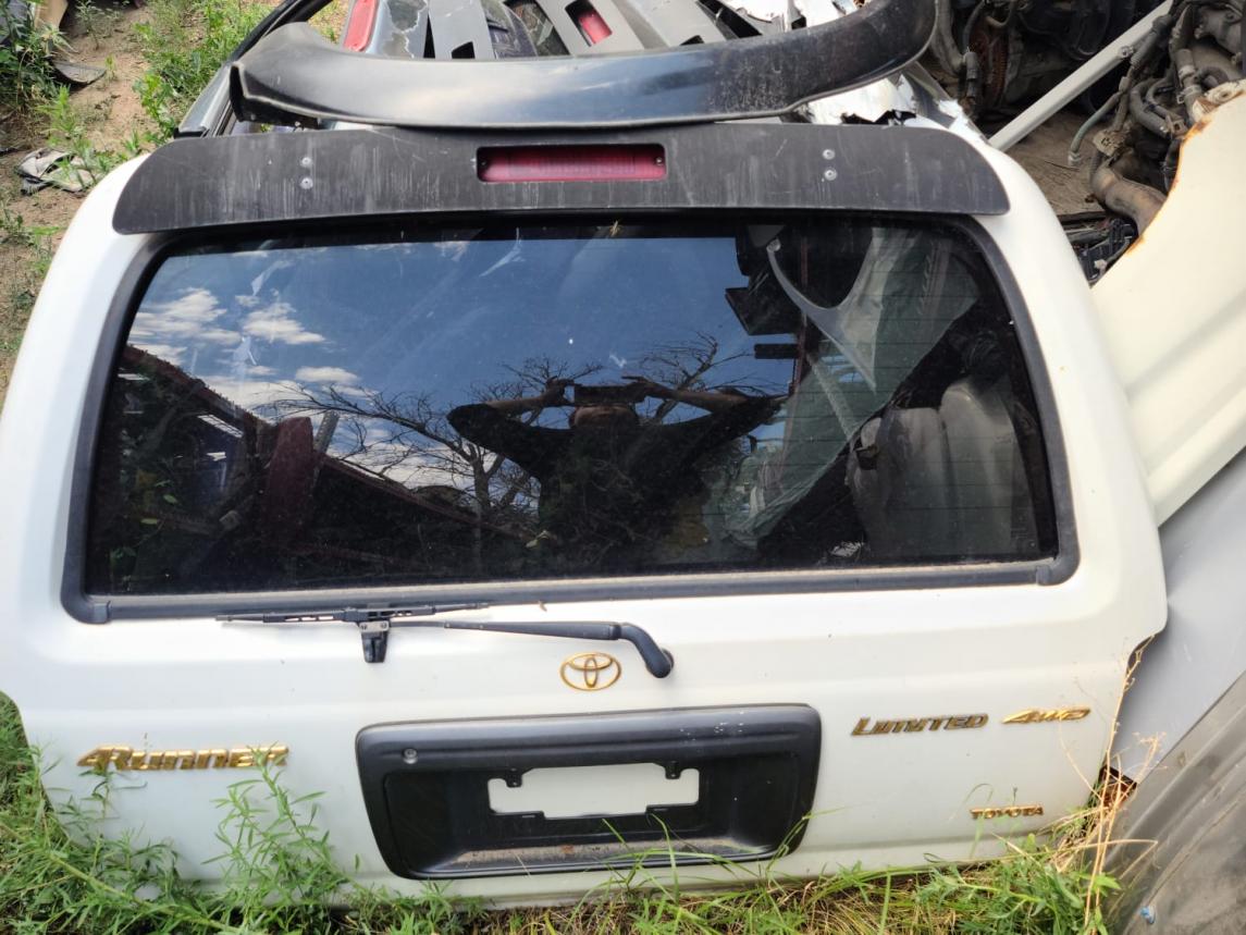

Is this a tailgate from a 1996 to 1998 4Runner??
Hello all,
I'm looking for a replacement tailgate for my '96 and want to get one from a '96 to '98 because they share the same guts.
I found one at a junkyard and I'm being told it's from a '98 at the latest. It looks more like it's from a '99 to me, based on the badging locations. Is it possible it's from a late '98? I suppose I could check the plug before I buy it, but I'd rather not waste the trip if it's clearly from a later model.
Thanks in advance for any help from someone on the forum who knows the details between the years better than I do.

If it is; just take the guts out and swap it over.
The license plate garnish is a dead giveaway. That's more likely a 99-00 hatch. Could be 01-02 also.
Probably have to swap the guts from the original hatch over to the donor hatch. Not impossible but time consuming for sure

Correct, you have to keep the wiring and components to match your chassis. So the wiring modules, etc, need to match your rig.
The wiring of the original hatch plus all the modules, etc, in the other hatch will work. Don't mix and match not going to work. There are too many changes in the circuits from mid gen to late gen.
I wouldn't even try the wiper and the window regulators. [ they may but you have it all]
The metal hatches identical same with the doors and body panels.
This is the sake for the doors and engine harnesses. Always keep the original wire harnesses intact with their pieces. If you do. Your stuff works. :)
