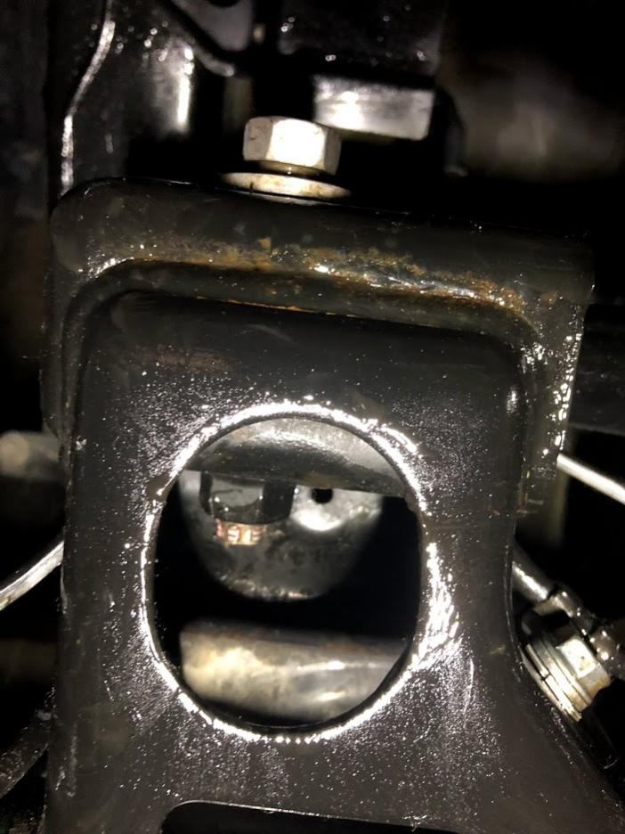

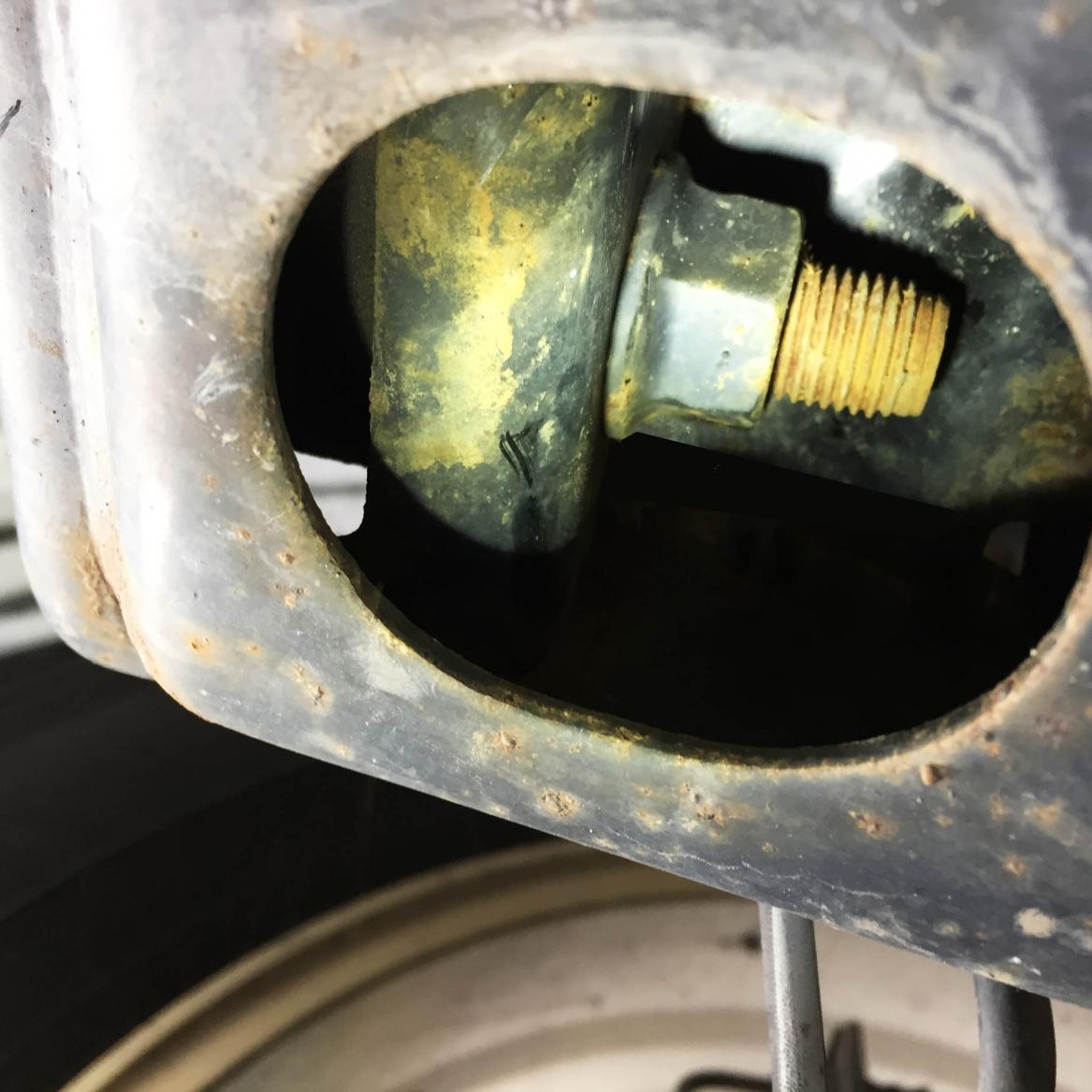

Here is the photo of how loose it is
attachment.php
The other side of this piece is tight, but not the driver side. Does not seem normal that it is that loose. I tried to tighten it, but the bolt is very tight(yet has big gap between the washer and the head) and the nut looks very different.

Unfortunately, the shop I had it done is few countries away. I gotto take care of it soon. I have been driving like this for at least 6 months now. Thanks for the advice. I got torque wrench. Does anyone know what size bolt that is?
Everything suspension related in the rear is 19 or 17mm. I’m pretty sure that one is 19mm
It was 19mm. For some reason the nut is bigger maybe like 22mm? The other side of panhand bar has exact same 19mm nut and bolt. Not sure why driver side bolt is so much bigger and different color(black). Seems like that shop might have used different size nut than the factory one.
Anyways, I tried to tighten the bolt, but it would not budge. Strange it got like 5mm gap between washer and the bolt, but it would not move.
So not sure because it would not move, should i call it a day or because there is little gap would it cause problem.
well, here's the thing....
If you didn't touch this, then the shop that did your shocks did for some unknown reason (panhard bar does not need to be removed to install shocks or springs). I'd say they stripped something, and put that clusterf-ck nut on the backside.

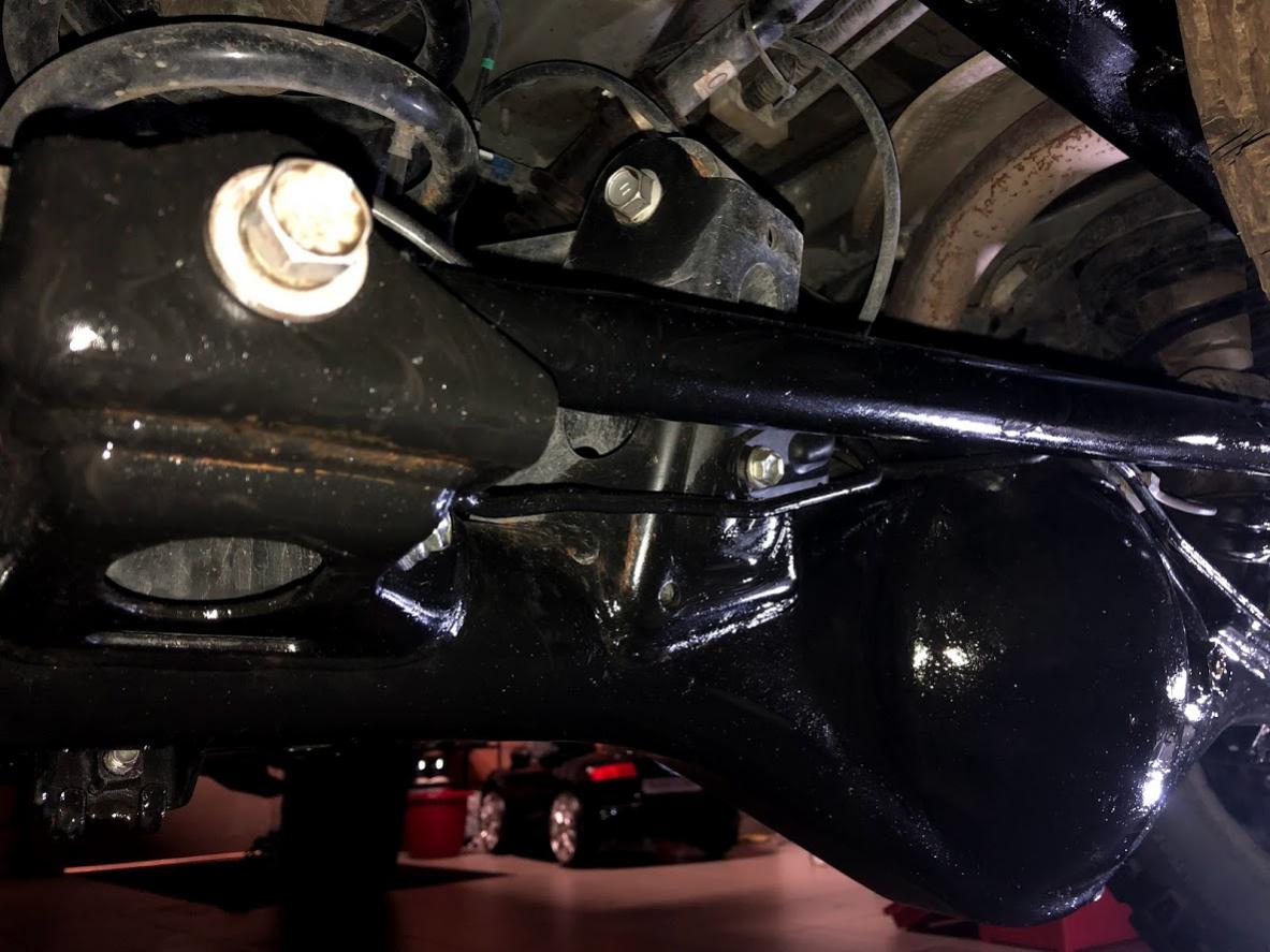

here's a photo of what mine looks like. IIRC, the nut is tackwelded to the bracket itself.
I would imagine that must be clunking over bumps....?

Thanks for taking the time to take picture of your rig. Ya it is strange. It is hard to tell now if it was those guys or the people who installed my stage 2 kit originally. If I lived in the states, would have been very simple to get it fixed. Makes it hard being overseas and knowing little about this kinda stuff. At least this forum has been my goto source for many things.
