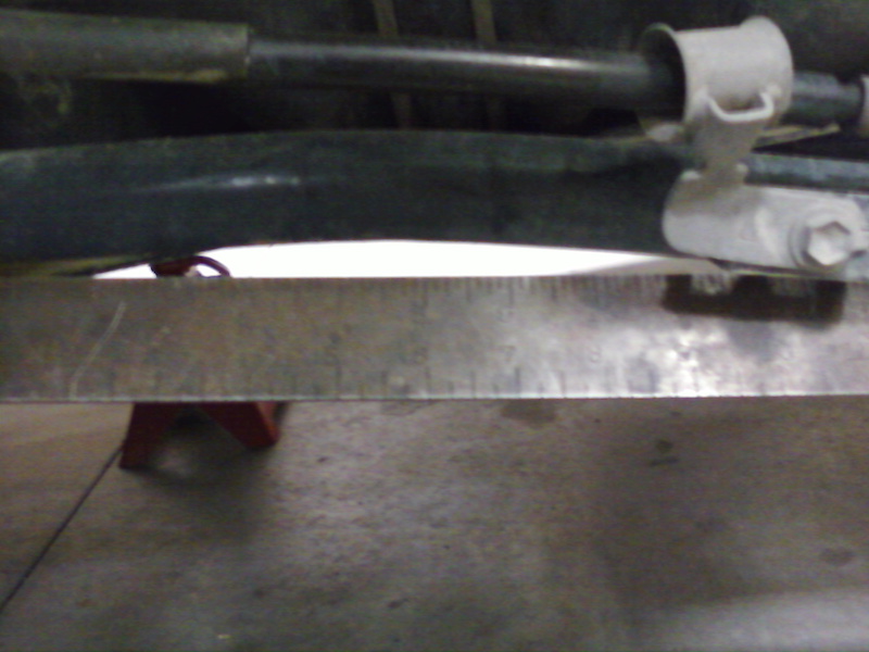

I have been known to bend them in the rocks.

Woops!
I belive someone on here makes rear LCA's with a gussets welded to each side or like a piece of shedule 40 box with the top cut off slipped over the bottom half of the LCA and welded for the length of the arm to give you some ridgidity and rock sliding and slamming protection.
