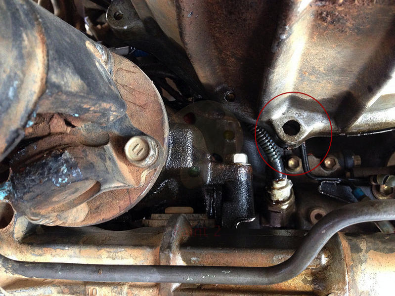

I have signs of oil in the area you are seeing as well. Its never enough to drip onto the driveway but still annoying. I just changed the oil and went full synthetic and will monitor it more.
Question though.
Is there supposed to be a bolt on the other side of the circled area in the picture below? Only asking because I do not have a bolt there.
