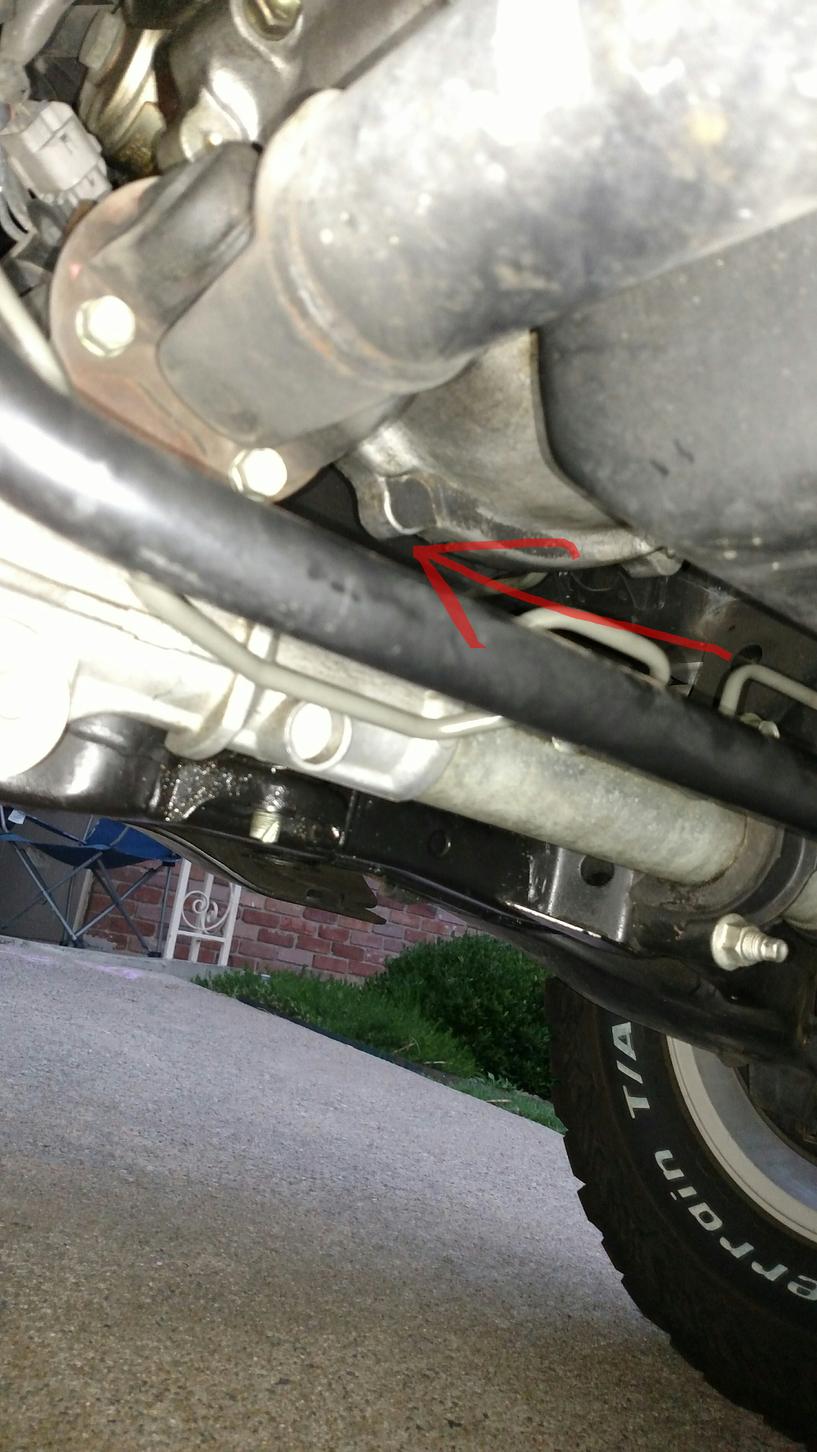

Update: had valve cover gaskets redone. Cam plugs. Cam seals. Spark plug grommets. New pcv valve/grommet. Pretty much had every seal and grommet replaced that can be done, except the rear main seal.
I went to a better shop and they said the last ones didn't do any clean up around valve cover gaskets and didn't silicon half moons. I still have a tiny tiny drip where I've drawn the arrow. It so minimal it doesn't drip on the driveway. Is this where you would expect a rear main seal to leak? I'm wondering if it could still be residual. It's been about 3 weeks since the work was done.

I'd say that in the general area of the rear main but could also be the oil pan? If you have minimal rust and it looks like you do, you could check and tighten the oil pan bolts to spec...

I went to a better shop and they said the last ones didn't do any clean up around valve cover gaskets and didn't silicon half moons. I still have a tiny tiny drip where I've drawn the arrow. It so minimal it doesn't drip on the driveway. Is this where you would expect a test main seal to leak? I'm wondering if it could still be residual. It's been about 3 weeks since the work was done.
Well hopefully they put FIPG or the like in ALL the required places. Hopefully they used OEM parts.
It sounds like it's slowed down to almost a stop since the repair. Could be residue even 3 weeks later. Not sure what the leak rate was before the repair. I would get some engine degreaser and saturate the back and bottom of the motor and pressure wash the areas really well then keep a close eye on it. As a matter of fact, right after cleaning it up, take it for a good drive and then crawl under there a see if it's coming from the seam. If it is, then it very well could be the rear main seal.

Thanks for the speedy responses! Yes we used all OEM parts and made sure FIPG was used in all necessary places. Also proper torque on everything. I bought some cleaner yesterday and am going to spray everything down and power wash this weekend. The leaking was considerably worse before. It was leaking on both sides of the bell housing and middle. I reached up there yesterday on the flat side of the casing where it butts up to the pan and had a little fresh oil on the rag. I drove about 10 miles this morning and there is a tiny bit of oil where I drew the arrow on the picture above. Frustrating

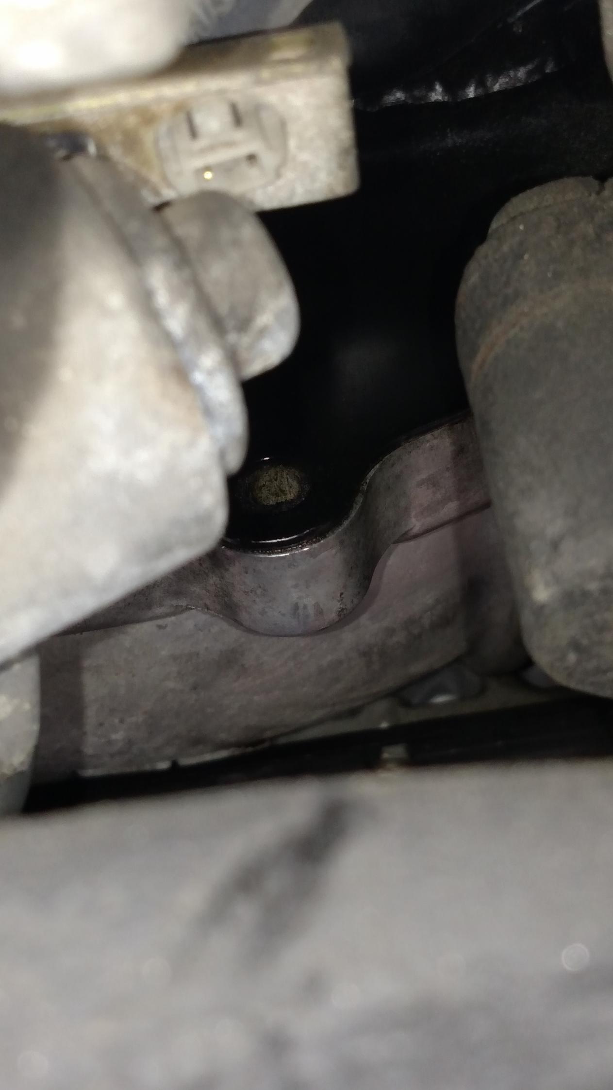

So I got under and did some looking today. Sprayed break cleaner over everything and washed real good last night. Wonder if the hole on the front side of the bell casing in the picture below is a closed hole or open? Pretty sure this is where the oil is coming from if open. Everything above looked very clean. I noticed the back of the oil pan kind of sets back in the bell housing.

It's a drainage hole and if it is leaking from there (through the hole) it's the rear main........if you let the vehicle warm up you should see it leak right through that very hole while it's running.
Boom! That's gotta be it. Guess I'll live with it for a while. I'm out of funds chasing these oil leaks.

Get a small stiff wire and poke the drain hole a couple times to clear the passage. Be advised oil may come out.
