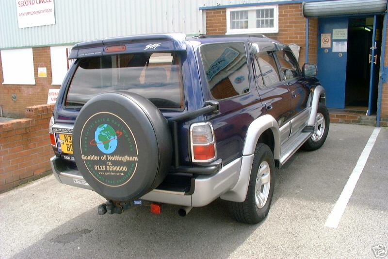

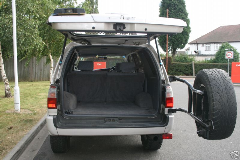

The spare can be mounted to the body. The US market just never got that option for some dumb reason.
If you can get hold of the frame and all other bits from overseas then your good to go. They are available, just very expensive with shipping. I nearly bought a complete setup from ebay uk, but it got priced out of my league.
