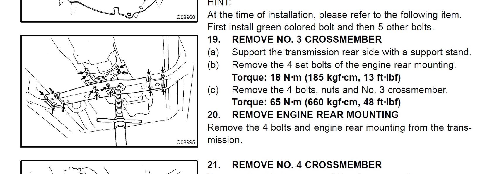

Somehow, one of the four upper bolts for my Rear Mounting Insulator fell out.
I've been trying to make sure I know the proper bolt size to get, and so far the best information I can find is that the bolt should be OEM part number 90119A0031. I was planning to just take out one of the other three bolts, go to NAPA, and show them the bolt but I don't know the proper torque specs and it seems prudent to not have half my bolts improperly tightened...
Can anyone confirm the proper bolt in question I need for a '97 automatic T4R SR5 and if so, could you also provide the proper torque specs for the bolts? I've looked around and can't seem to find torque specs for the bolts that go on the Rear Mounting Insulator.
If someone could also point out where I could find the part number for the Rear Mounting Insulator, that'd be nice too, just for the sake of learning.
EDIT: Seems the torque specs are 48 ft-lbs. If anyone thinks that is incorrect I am all ears.
If this is what you're talking about, it looks like the FSM says 48ft lbs. Kind of hard to tell which bolts they are talking about.
On second thought, maybe it's 13ft lbs...?
