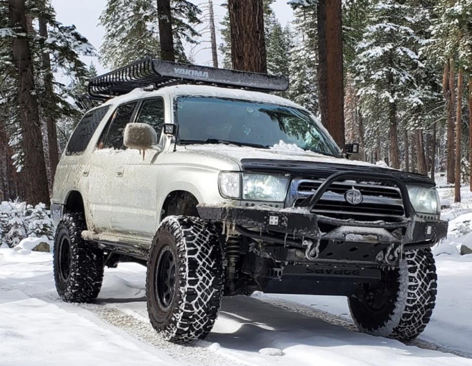

Hi All,
I have not been able to get an answer that has explained this so here we are again.
While in Tahoe I had just come from a small trail in the area and used 4wd and the rig felt normal the back would follow the front with no issues. Uphills and down on flat all of the above. The snow was light and there was some ice.
Heading back into town I was in 2wd having no issues and stopped at a light. I did not want to be the guy that slides sideways to get going as now cars were next to me. I put it in 4H and took off and immediately it felt as if the back end wanted to come around and it was at less than 5mph. This is the first time this has ever happened in this 4runner and the first time I did not feel comfortable driving it. Normally this would not bother me but it was bad no matter the speed it just wanted to come around.
I pulled into a parking lot and checked links and bolts thinking something came loose and could find nothing.
Tried 4hi and 4 lo and they felt the same. Luckily I did not need 4wd to head out and drove home in 2wd with no problems. Any thoughts?
I have a 2000 t4r with a 3" lift on 285/75/16 Goodyear Duratracks 4 bikes on a rack on the back and some tools and bags in the back. I don't think the weight or lack of was a problem.
