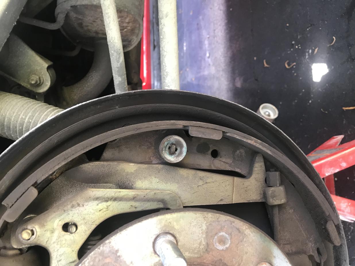

Hey all. So I’ve been getting an intermittent brake light in the mornings and I was figuring it was the brake reservoir slightly low as a result of pad wear. My front brakes have plenty of pad life and I figured I’d give my rear drum pads a look. They look like they need a change at some point but nothing super imminent. Just looking for an objective opinion!
They’re all more or less in the same condition though some were slightly uneven in their wear (is that an adjustment thing?)
Thanks in advance.

It's very common for them to wear unevenly like that. Has to do with how and where the piston applies pressure to the shoes.
They will last a little bit longer but you will want to replace before you get metal-on-metal contact from the shoes.

So I specifically checked the cylinders for leaks, inside the drum was bone-dry just crusty and old. I sprayed everything with brake clean and called it a day. The boots on the cylinders were also pretty soft, rubber felt good.
It's possible there's a leak somewhere, but it could also just be front brake pad wear, I put the new front pads on about 10,000 miles ago and topped the fluid right up to the line.

Brake shoes last a very very long time. If I had to guess, the thinnest part (middle) looks to be about 50% worn out. You have atleast 50,000 kms left on those shoes IMO.
