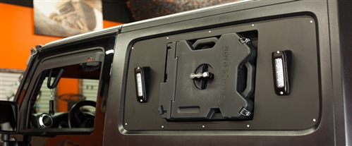

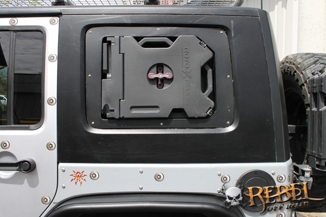

That's what I'm talking
ROR-JK-BOK-V2-4DR-BASIC-2.jpg about

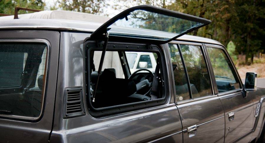

This could be a cool product, and you could have some different options like a place for mounting gear, or just flip out windows for access to the rear something like these ones for fj60s from Wagon Gear. I think it would be nice from an access standpoint even if the "windows" were just panels that match the body curve and open.

Yes I’d love a gullwing option for our rigs. These ones for the 80 series LC are pretty cool.

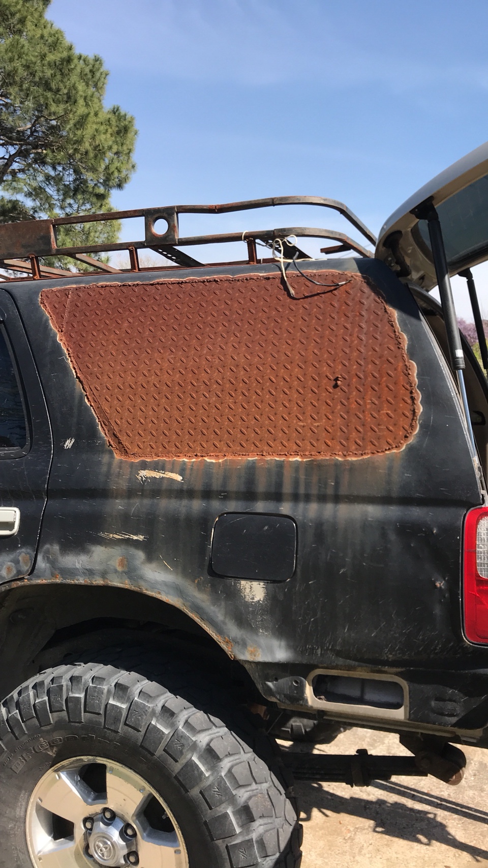

I’m working on something.
I laid my rig over wheeling.
The glass was like 400, the diamond plate and welding was like 20.
Cutting that one out, and the other side is coming out, and working on a full wing system.
Got ideas, just not enough time to put them to metal yet.
I think I'll pull the trigger for that this summer. Will post how it will look like. I took a look and I don't see too much curve on my 2001. Will do flat metal.
