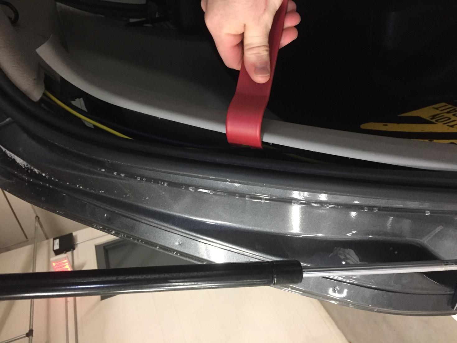

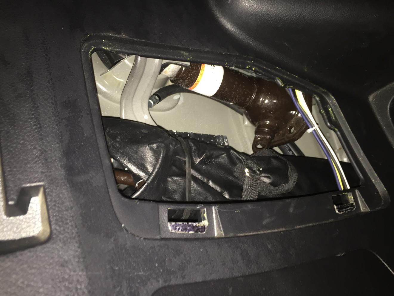

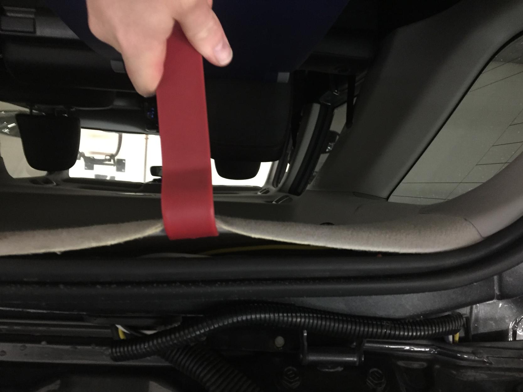

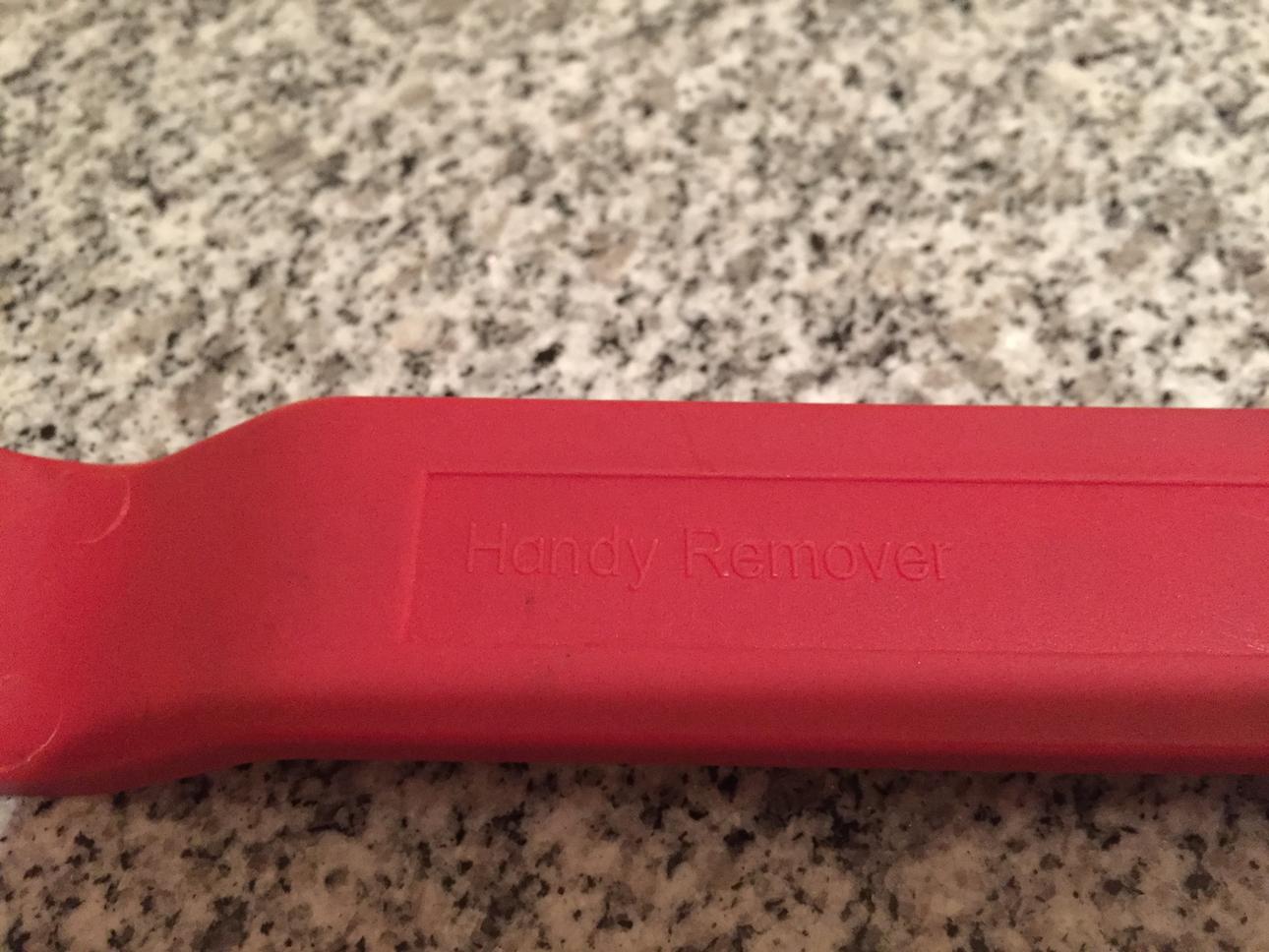

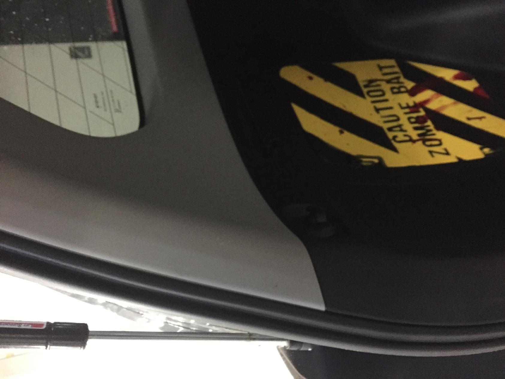

Not sure if this is what you are looking for but you need to get yourself a "handy remover" or similar tool and just pull down on the edge of the panels.
Photos are worth 1000 words right
No idea why they are sideways this time around....

Awesome, thanks so much
Light pressure to get off, and they will snap back into place?
Yea, you can put a wrinkle in your headliner if you get to aggressive but just ease into it and don't just pry on one place if it doesn't want to move
