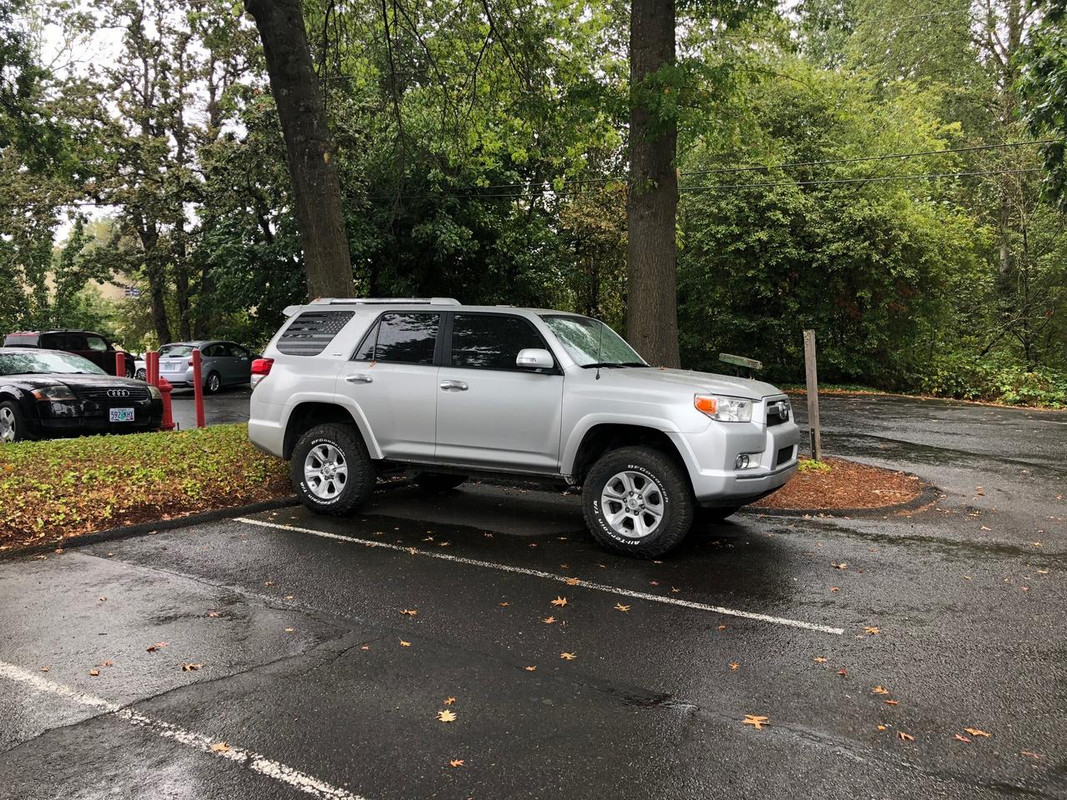

I just measured my stock Ltd. and there's a 2" rake, so if you're kit raised front and rear by 2.5", you'd need things to sag 2+" for the rear to be even with, or lower than the front. Can you link to the kit you used?

Op: you may want to either post pics of how you installed the spacers or have someone look at it.
its not the shock... A shock piston extends, not shortens.
.post pics of your front and rear spacer install or have someone take a look at it.

not a bad idea on the test, but if he's running OEM shocks, I"m more interested on how he installed those spacers.
Install wasn’t difficult, I followed the manufacture instructions and watched the videos. It’s really hard to install them wrong. I’ll try and post a picture. Maybe it’s just my mind playing tricks on me.
I had the trunk fully loaded this weekend, just got back from a camping trip. The picture above is fully empty. I guess I could try the posted advise earlier and d/c the shocks to see if they are applying pressure to the springs? The picture here makes it look normal so I guess i'm wondering if upgraded shocks for the rear will have any impact on height.
