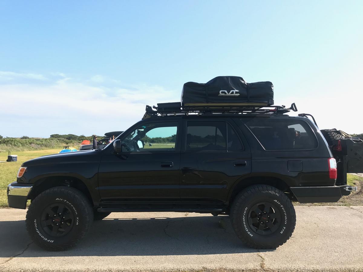

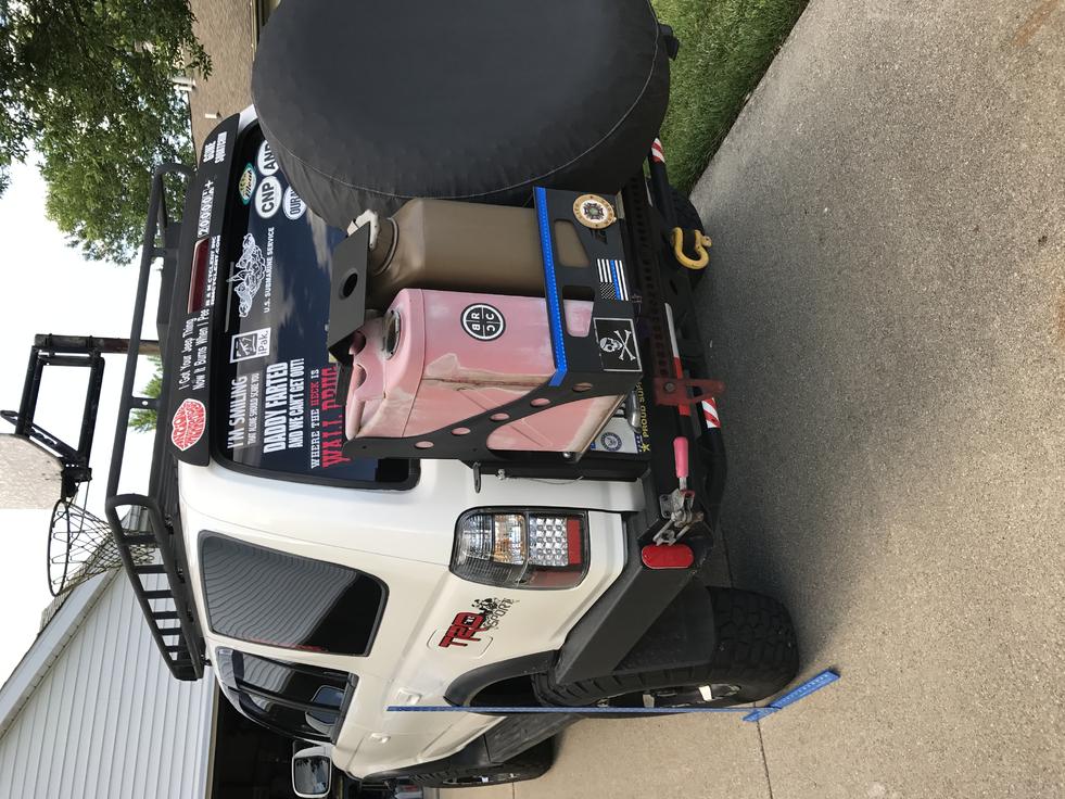

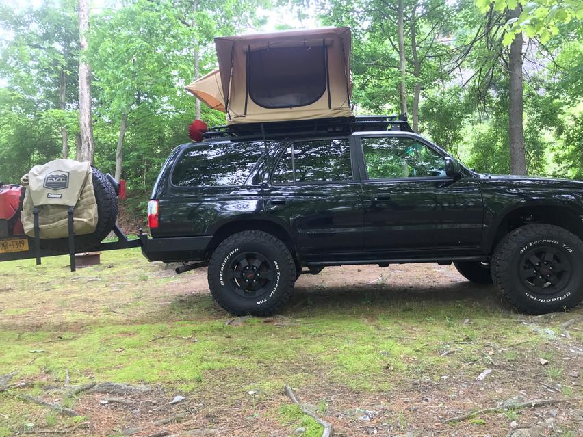

I Have the toytec boss suspension lift kit with the 9602RC coils in the rear. After loading up my vehicle with the spare tire, cargo box, cargo, tent etc. I am sagging..bad. I even lowered the front 1' to try to compensate, but didnt really help.
Anyone know the proper way to address this? I heard OME 891 coils, or then a load leveling kit..
Not sure which rout to take, I am looking for reliability, longevity, and low maintenance.
Thanks!

Is that a CBI bumper in the rear? 891s won't help you. My 891s started to sag with just my CBI. I moved up to 861s with the Black LC shocks. So much better. You'll have a rake when unloaded but levels out great when loaded. For me, it's just what I was looking for.
Sent from my SM-G920I using Tapatalk
I had the same thing happen with toytec rears. I switched to ome 861 (fj80 front springs] and lc80 tokico blacks. Perfect handling the weight.
Sent from my SM-G930P using Tapatalk
