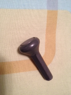

Photo attached for clarification.
Well, I've lost one and the other sits so low/tight to the seat it's difficult to grasp and pull up to release the seat.
Is there a better option?
If I decide the jerry rig it, what size bolt is it screwing into?

if its way down into the seat then youll need to take the bracket off and bend the rod back up. its really easy to fix, first you will have to tilt the rear seat forward then unscrew the knob all the way out. next youll see two bolts on the side of seat where the latch is pull the locking unit out then bend the rod back upwards till it sticks out of the top of the hole where the knob goes just a hair.
then reinstall the unit and screw the knob back on yourll be good to go!.
That gets me to the point that it's easier to reinstall the knob I have.
However, I'm still short a knob.
Suggested replacement?
Toyota?
Jerry rig?
