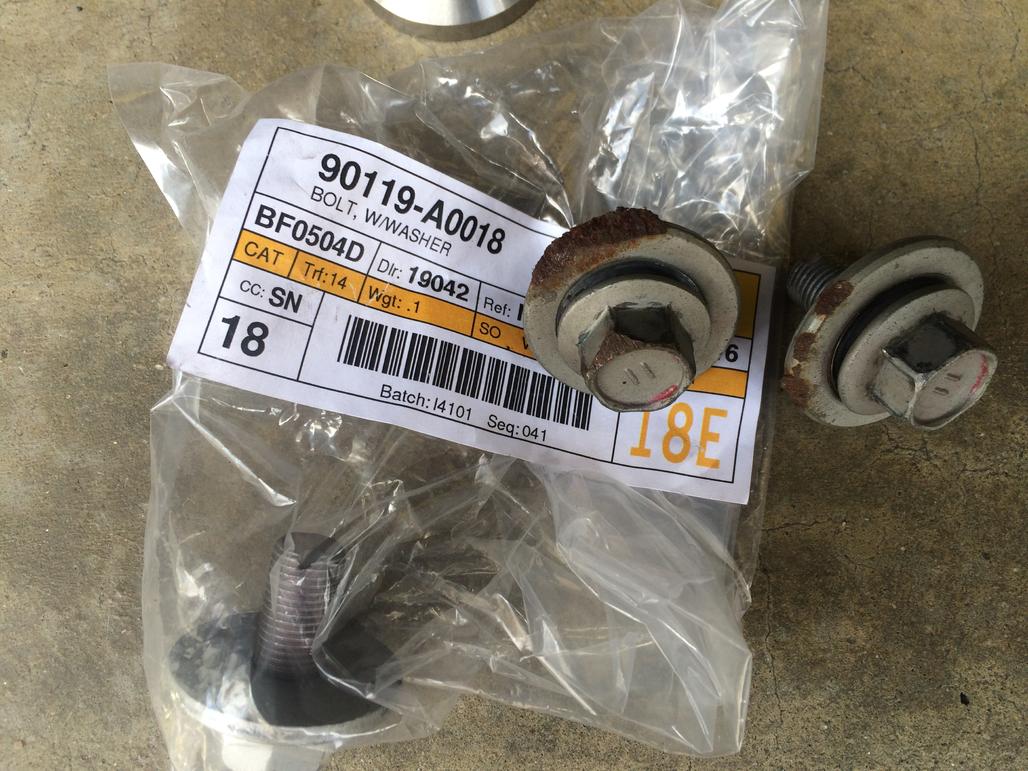

I had bashed one of my lower shock mount bolts and bought the FJToyman lower shock mount skid and decided to buy two new shock mount bolts. This was the PN from Toyota. Took a day to get them in.
Ended up picking up a M12x1.25 30 and that worked like a charm. Went to the hardware store because my local dealer is terrible. Cost was about the same. $2.50 per bolt and 0.50 per washer.
Toyota part number: 90119-A0018 (so you can copy and paste instead of retyping of the image)
