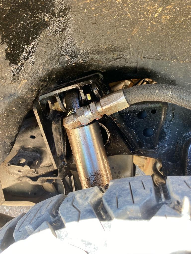

Disregard the fact that my shock lost all its oil but this is the best photo I have of my relocation at this time.
This is exactly what I was thinking... but I'd have to preserve the way the OEM mounts because I already have a shock. I totally think it could be done! Thx!
