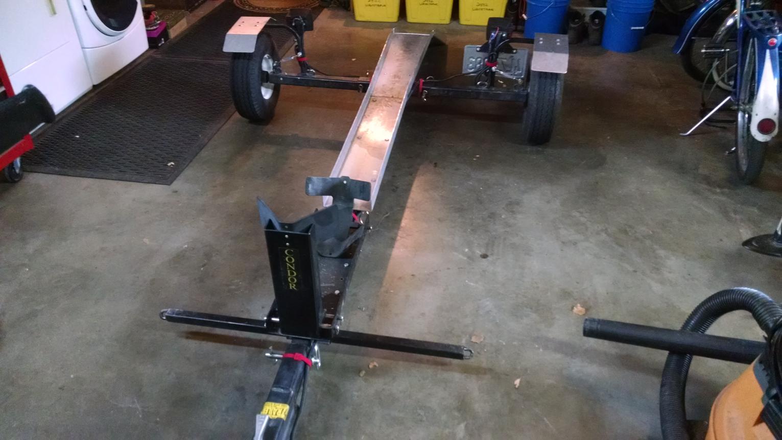

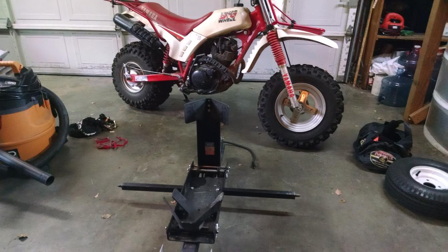

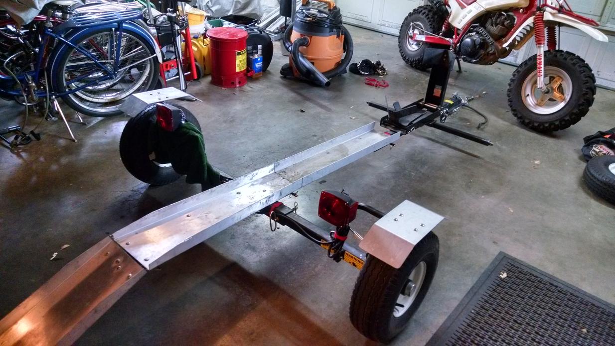

I thought about a hitch carrier at first when I was looking to travel with my motorcycle. But, knowing I'd also be carrying a ton of other gear and tools in the back of the truck, I thought it would better to keep all that extra weight off my rear suspension and buy myself a small motorcycle trailer instead.
I found a trailer called, "Trailer in a Bag". It's a cool set-up that pieces together with channel iron so it's easy to store in your garage or wherever. The only problem is the guy that owned the company passed away and I don't know if anyone else picked up the torch and is making them again. But, you could probably find one used on Craigslist like I did. Or, any good modification/welder type could easily copy the design. I'll be assembling mine today for a trip on taking this week. I'll take a pic and post it when I'm done.
Here's some pics of the Trailer in a Bag just to give you another option instead of putting all the weight on your suspension.
