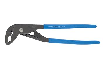

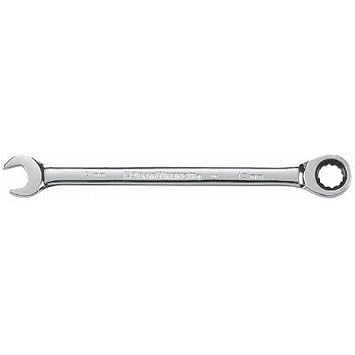

I used a ratcheting wrench, and a GL10 channellock to hold the shock so it wouldn't turn.

Knipex Cobra and a ratcheting wrench make quick work of the removal for me.
The Knipex to hold the shaft so it doesn't rotate and the wrench to take the nut off.
