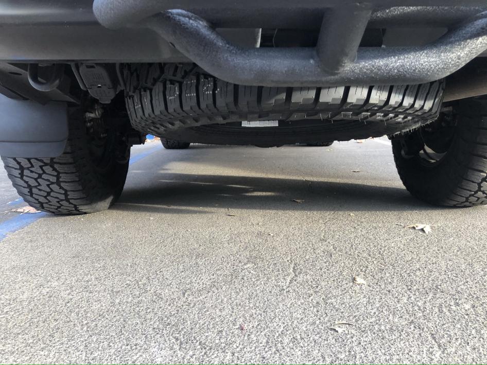

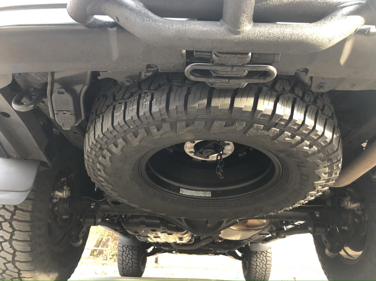

A 285/70-17 AT3 fit perfectly in my spare tire location. No KDSS, but, I’ve read where members are getting this size to fit, it’s just tighter. Someone makes UHMW spare tire skid plates for this location too.
