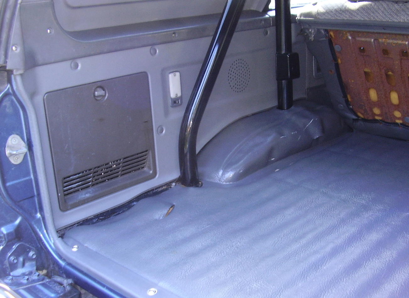

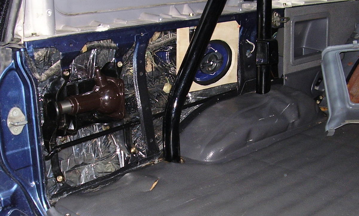

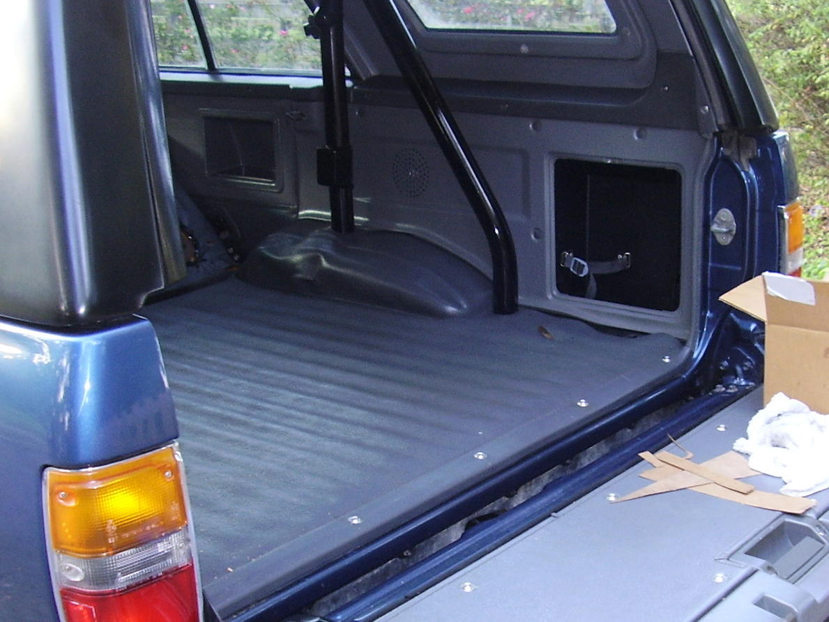

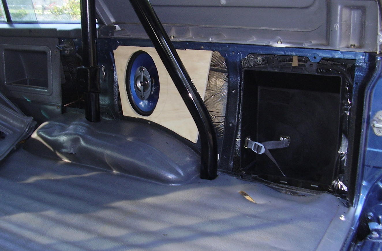

This may help, here is my 6x9 install in my first gen. I'm sure the 90 to 95 is about the same in back and a similar install would work:hello:
