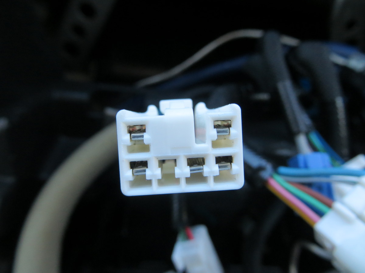

It could be that the plug for the rear speakers is disconnected. It's a 5-terminal plug on the back of the head unit. Looks like this:
Just pulled head unit out every thing was good. But I unplugged all the harness goin n to headunit why didn't it reset everything still set the way I setup I got hooked back up still same no sound from rear
