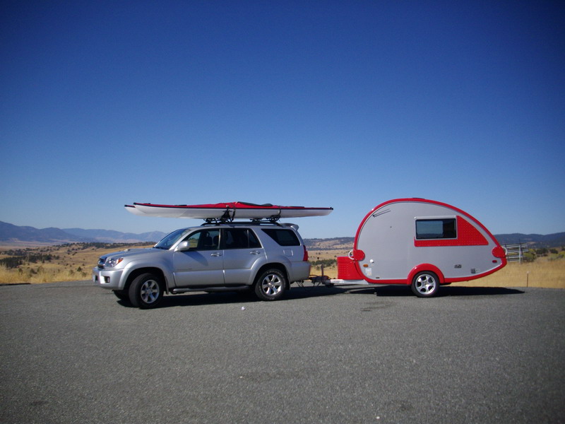

With regards to the Rear Spoiler Poll: Does anyone have experience with removing the spoiler? I've hammered mine loading and unloading my gear and would love to remove it...

SJ - nice set up. We have 3 boats - all sit on tops (14',12' and a 9 foot Prijon Twister play boat to surf with) but no pull behind rig. That thing must make camping like home? Does it have AC or do you not need it out west?
I have busted up my spoiler a bit as well loading the boats. It's hard to keep them off it if you load from the back. All of the marks are pretty much on the top or back edge and with the lift you can't em unless the lid is in the open position. Also the plastic is kind of the color of the truck so they don't stand out much. I was thinking about addding some felt or something to the top just to make it slide easy but, they may look too red neck. Not sure about removing it. Should not be to hard but like mentioned you will have some holes to fill. I have also see a addition to a Yak rack that sticks out to the side that lets you load from the back but then slide it over. Good luck and tell us about the rig. Sleeps how many? Any awning? Where do you take it? How bout some pix of it in action?

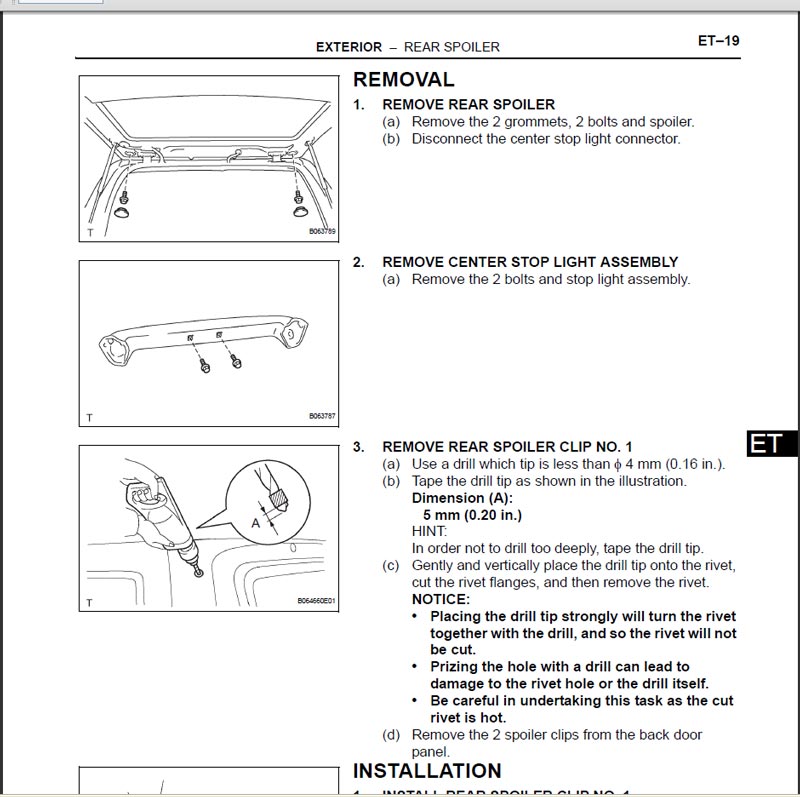

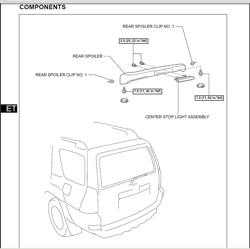

Here are the Repair Manual instructions for removal of the Spoiler.
