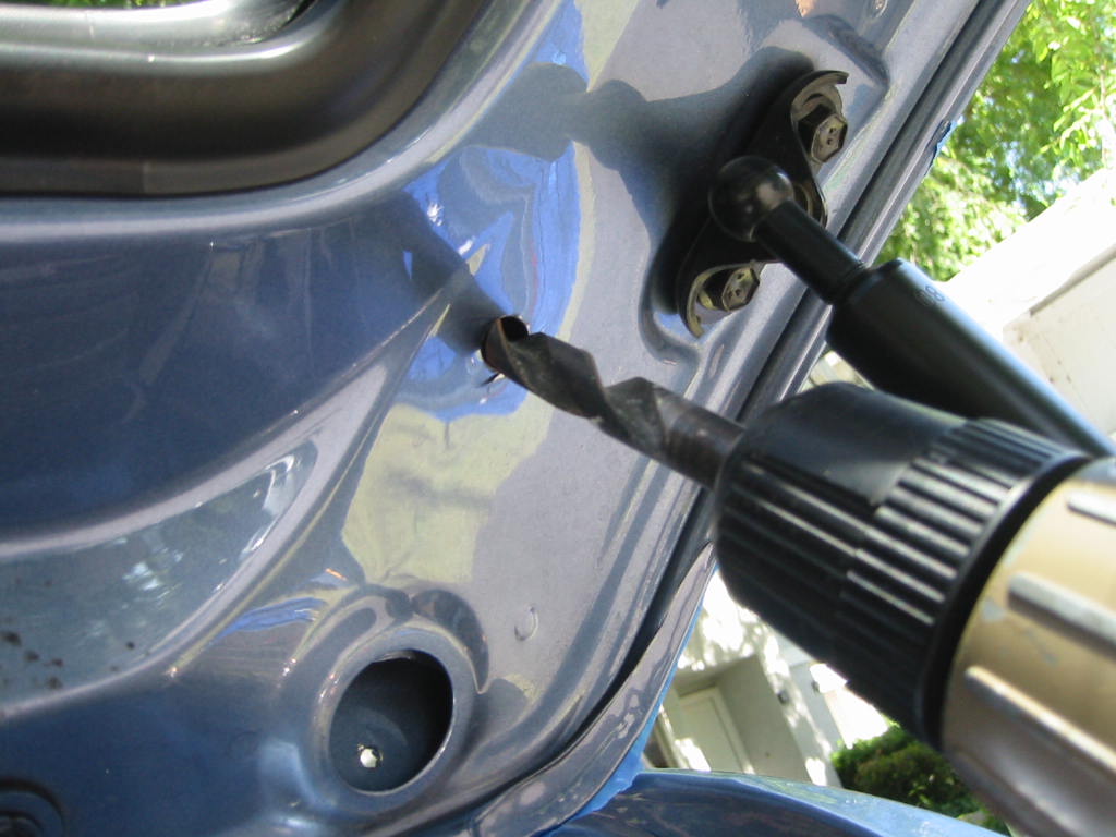

I got mine from Spoilerdepot.com back in May '04 including painting and shipping for $298.00. I believe they are a bit cheaper now......some on here have being stating prices in the $215-$250 ranges. Spoilerdepot will paint the spoiler to the exact Toyota manufactuer's paint code. I didn't have any problems as they used FedEX or UPS ground so you can track delivery. I believe all of the aftermarket spoilers have a different 3rd brake lamp than the OME models. I like the fact that my spoilerdepot model has a LED like lamp which is much brighter than the OME. Also be advised that the 3rd brake lamp is kind of lower than the OME one, which is directly on the back/flat part of the Toyota spoiler. In my opinion, the lower aftermarket lamp lense allows smaller vehicles to see you better. It's a rather easy modification.....you only have to drill 4 holes in your liftgate. The directions are pretty clear. Be advised that I had to drill a larger hole from the inside of the double sheet metal rear deck lid in order to access one of the screws to hold the spoiler on but the LOOK is well worth this mod to me. Good Luck!

I got my spoilerdepot spoiler painted for 159 + 26.50 shipping in april 2004. (Spoilerdepot was selling some on ebay) Ooo and there's a lifetime warranty on the paint--whatever that means. As for installation, I did it myself with the help of a friend. Piece of cake: just poke some holes and screw it in. But don't do it yourself if you don't think you're up to it.

Hey o9stealth5, do the instructions from SpoilerDepot show you where to drill (inside or outside) of the liftgate? Any drilling diagrams? I don't feel like paying $100+ for dealer/shop to put it on for me.
If so, can someone post the instruction on here??
