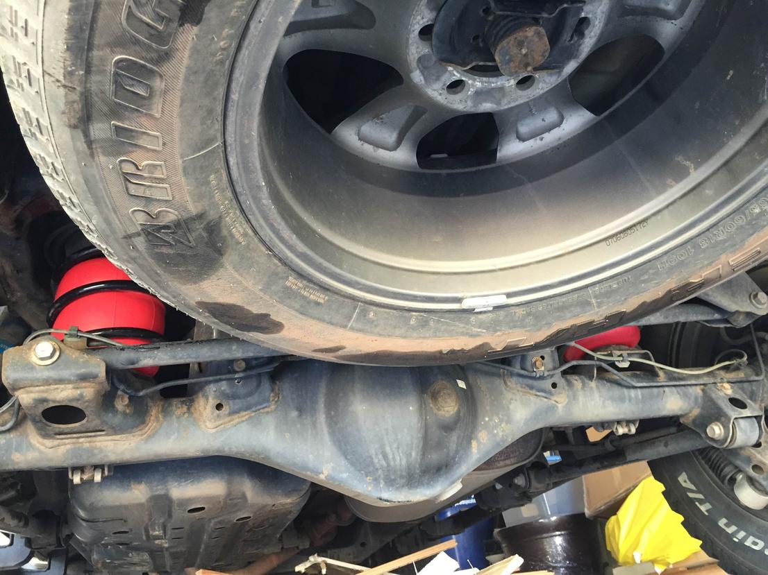

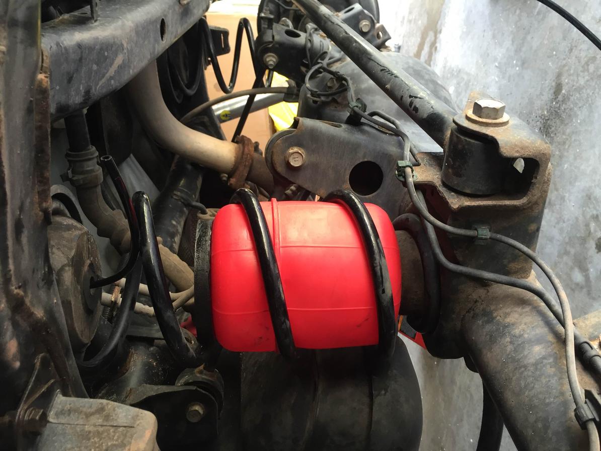

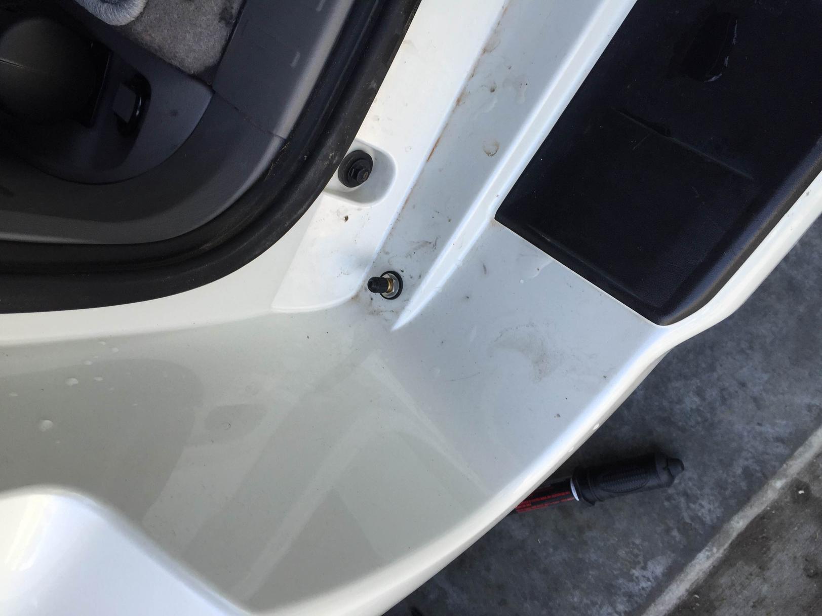

Airlift 1000 install
Again, thank you for all the replies. I wanted to post back and show that I installed airbags. $88 and hope it satisfies what I am looking for. For install, i did NOT remove the coils. I lifted and jackstand frame high as i could. I did remove spare and rear tires (rears may be optional) and cut the jounce bumper slowly with a saw zaw which worked perfect. I did route the lines up, instead of down per instructions. Lastly, did add plastic tube outside of airline for more protection. At 15psi and no load it gave the rear a half inch lift.
