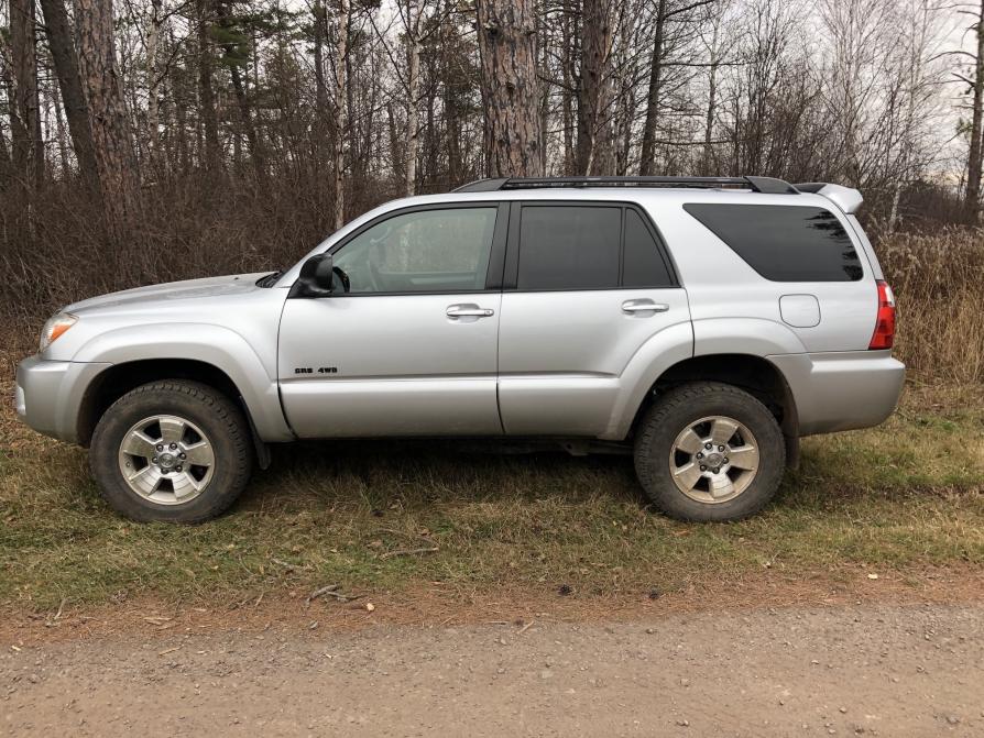

Ya you bought the wrong set, you need the 4130/4131 , also make note which one is driver side and which one is passenger side before you put them on.
Should look like the pic below when you're done. That's with KYB's on the back with Moog 4runner springs.
It raised everything up probably 1.5"-2.0" all around, my stock setup was noticeably sagging.

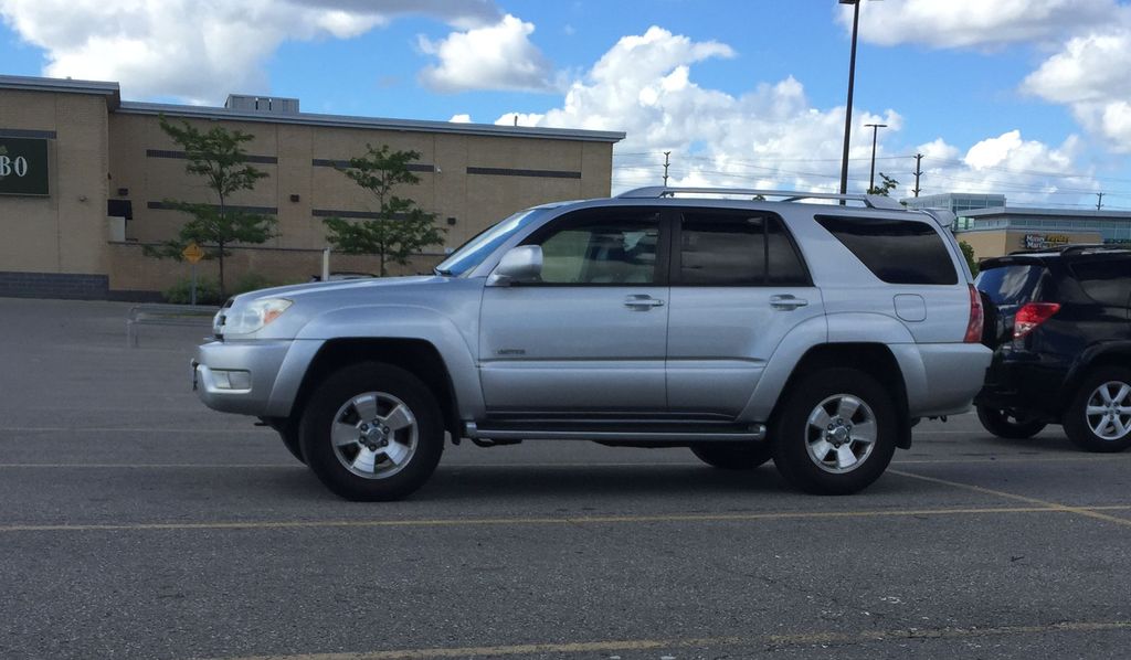

yep, you got the wrong part#'s. buy the correct 4wd ones & you will get the stock height back plus about 1-1.5" after they settle.
i replaced my xreas shocks at 145k & the KYB's are great shocks at a great price. heres mine after a couple thousand miles, front is about 1" higher than stock & rides great.

the kybs will settle. when i installed mine & first put it on the ground they were very high, like 2.5-3" higher than stock. after about 500 miles they settled about .5" & after 1000 miles they settled to where it is in the pic i posted, id say 1-1.5" above stock. & now at 2000+ miles they are still the same.

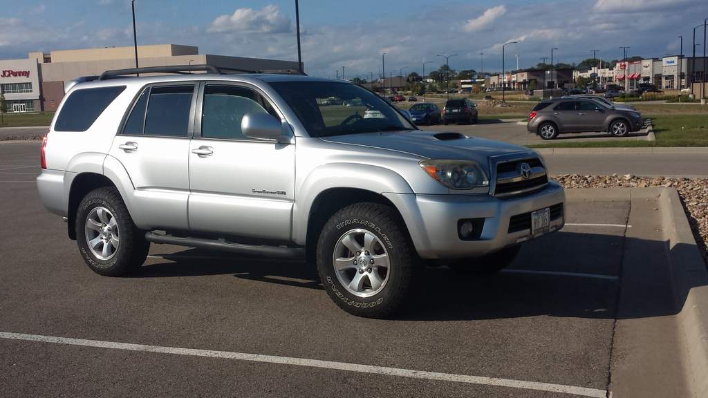

Here's mine not on totally level ground. Rear has Dobinsons 323 "stock height" coils - which gave about 1" over stock springs I replaced.
the height gained after kyb install depends on how worn out the stock shocks/springs were. if they were worn a lot then the increase would be more than if they weren't worn/sagged that much.
when i say mine gained 2.5"+ that is compared to the worn out front shocks/springs i had at 145k miles. that 2.5 settled to about 2" very quick after a few hundred miles. then what its at now i am comparing to what a stock ride is like, another member measured his stock height with lower miles & i measured mine after ~2000 miles & came out to be about a 1" gain over stock height.
my rear springs were not worn or sagged much if at all, probably due to the fact the prev owner was a little asian lady that never towed or loaded the rear with any weight.
also mine is a sport with xreas that may be different than SR5 shocks. but regardless of the difference, the kybs added a nice front lift & is closer to level than it was with worn shocks/springs or when they were new. i may add a small spacer if i want to be closer to actual level or the shocks settle more after a year or 2 & 10,000 miles.
