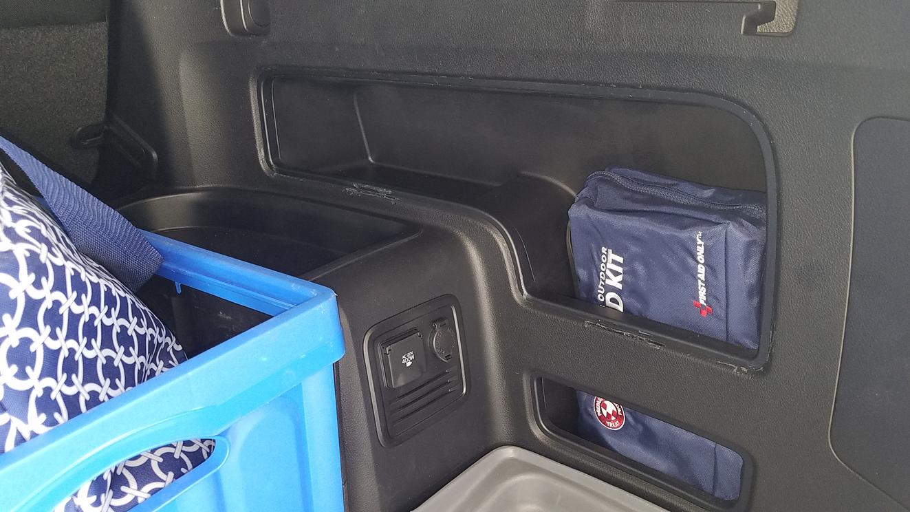

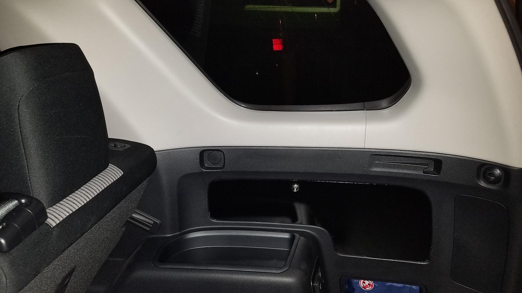

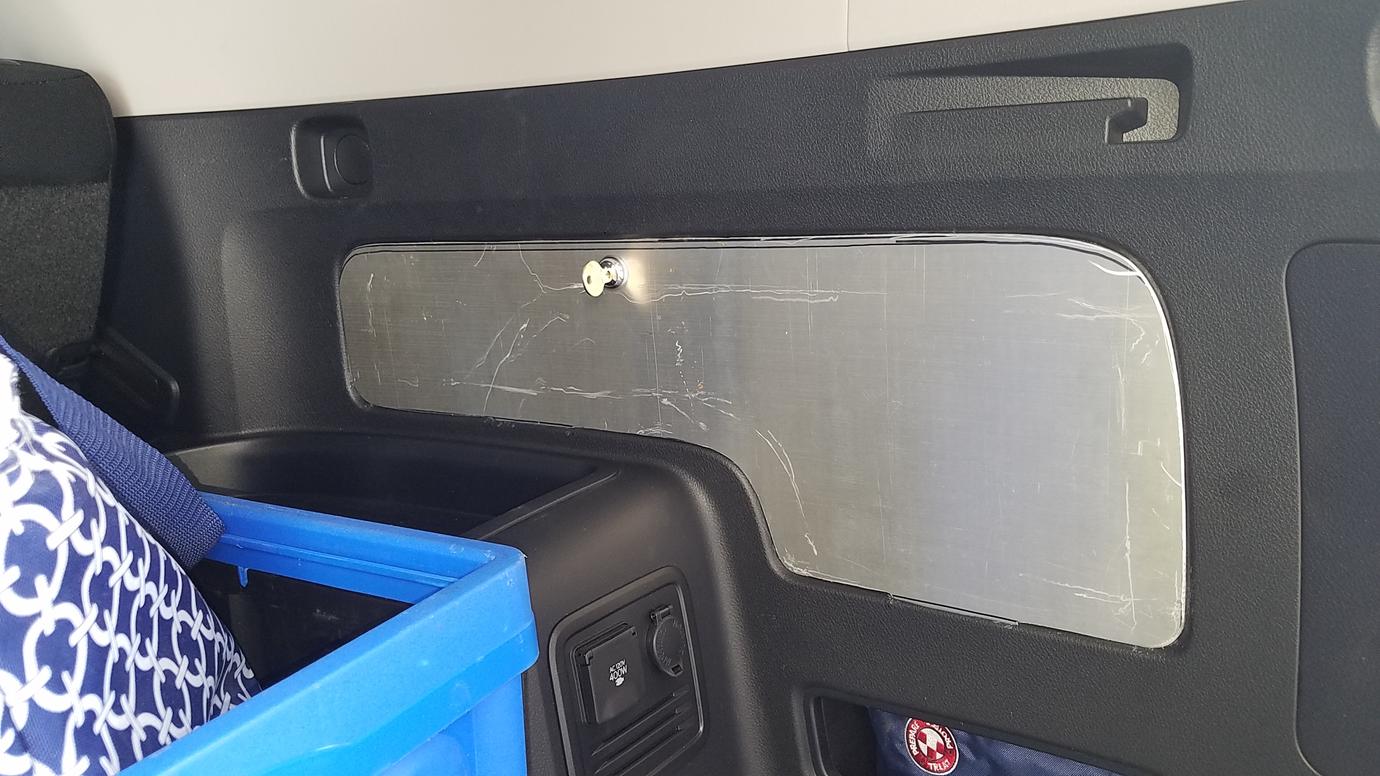

I got tired of looking at the gaping hole....and stuff I put in just fell out so I decided to whip out a mickymouse solution!http://www.toyota-4runner.org/attachment.php?attachmentid=289034&stc=1&d=1520823639 http://www.toyota-4runner.org/attachment.php?attachmentid=289035&stc=1&d=1520823731 http://www.toyota-4runner.org/attachment.php?attachmentid=289036&stc=1&d=1520823801 I think I will hit it with some black Plasti-dip for a better match. Material=some aluminum sheet (former sign....something about Radar Enforcement?!) a sheet of cardboard for a template and an alarm system door lock then black paint. There are two tabs at the bottom that go in the slots and the lock sucks the door up tight....no rattles!:D
I see the slot on the bottom to keep it in. What did you decide for the top
Great mod
The alarm lock has a wiper arm that swings into another slot in the top and it is solid! I could see doing this out of lexan or another kind of plastic material as well...I cut the aluminum with a jig saw. You could do a 2 piece hinge instead of slots too.
didnt notice it was a lock. I have a lock that has a handle too. So no need to lock it to keep it closed. Just a possible upgrade
I like the idea of a lock AND lever......I was just thinking of this spot as a good place to store guns if you have to leave them in the truck at the store or something.:mod:
Makes me wonder if you could fit a folded Kel-Tec Sub2000 in there with extra mags...... Surely a Henry AR7 should fit right?
I also wonder if a vinyl wrap would match the body molding a little better....

A Ruger 10/22 Takedown with the Magpul X-22 stock will fit (I just checked), but it has to lean outward because the buttstock is a bit bigger than the front part of the opening. But with the cover like you OP made, it would close and be fully concealed.
If you run iron sights with a tapered barrel, it might fit with the buttstock to the rear, but mine is a lite with an inexpensive red dot on it.
I think I can simulate the texture with some Plasti-Dip if I ''splatter'' it!:uzi:
I made a "false bottom" for my center console years ago out of aluminum. If you get some speaker cabinet carpet and some 3M interior spray adhesive you can cover that panel nicely.
Spray both surfaces, apply and trim with a razor blade.
Nice mod!

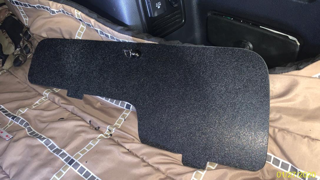

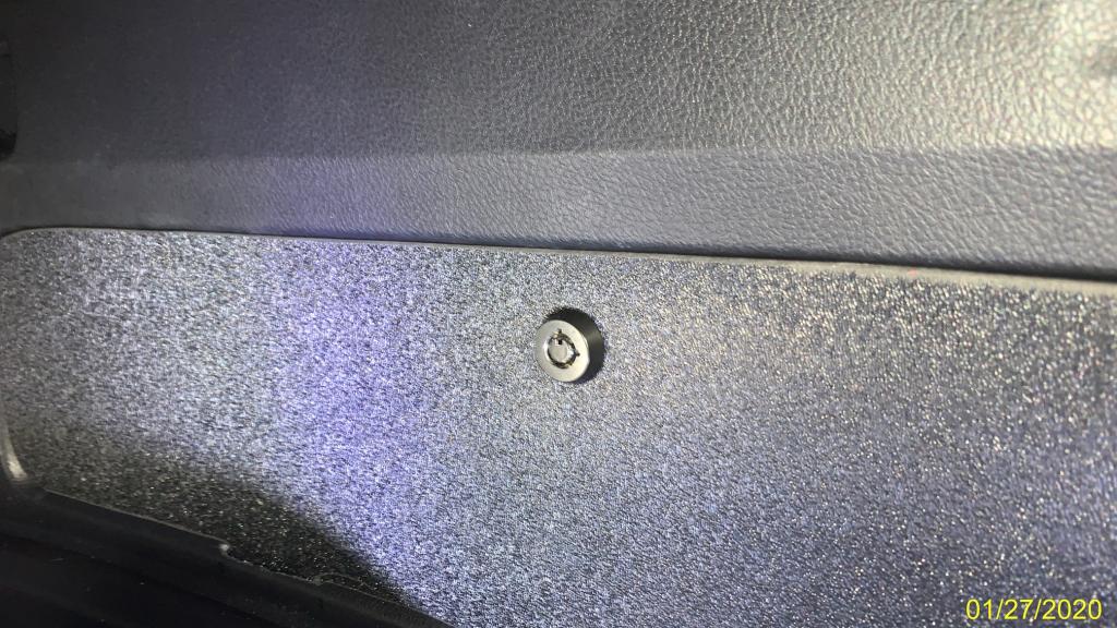

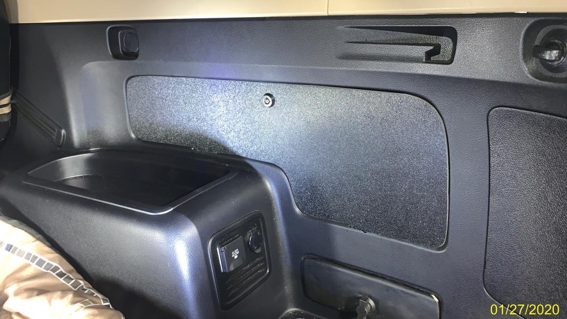

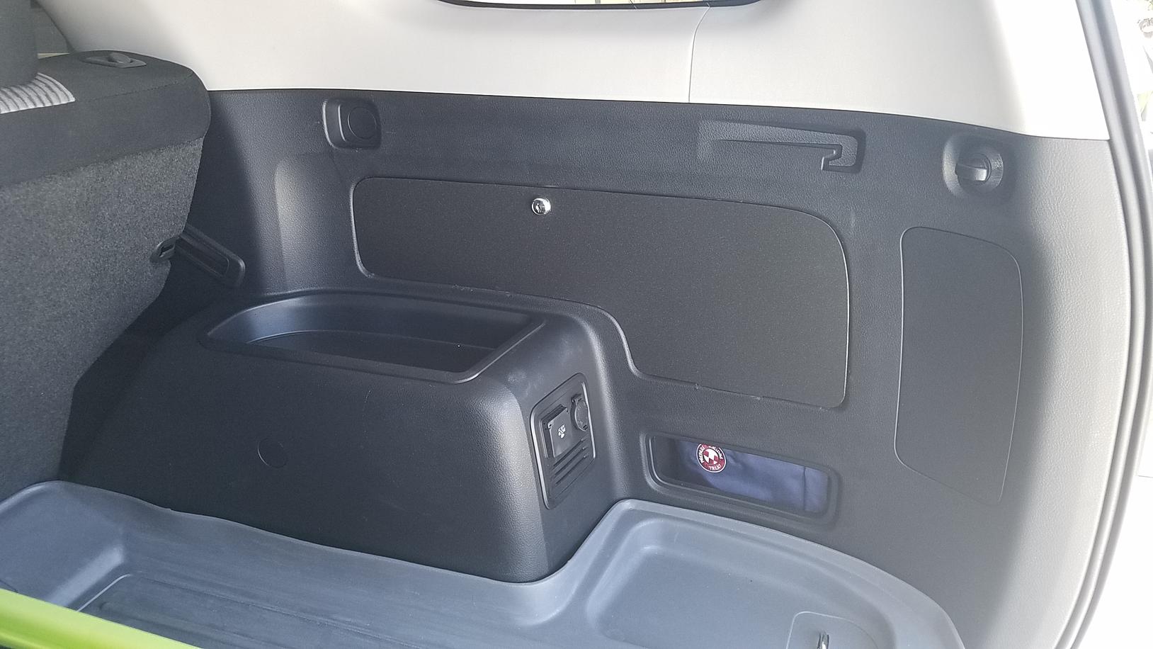

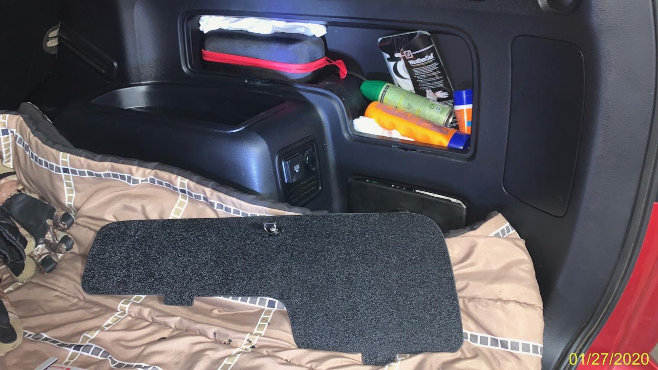

[MENTION=167491]83Mule[/MENTION] - thanks for posting this and the idea. Not sure why it took me so long to find that you did this mod - it has been driving me crazy not having a cover there like my son's 4th gen 4runner. I took your advice and used ABS plastic (textured).
That looks damn good! Nice job!
