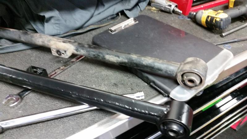

I would say it depends on what your needs are and what you're doing with the vehicle honestly? I have seen a lot of lifted 4th and 5th gens and they don't usually have any rubbing issues or clearance issues towards the back door area at 3" of lift for normal driving. I'll also suggest an affordable option if you decide you don't want to do an adjustable set-up for whatever reason; I took an extra set of rear lower links and stitch welded 1/8" angle bar to the bottom edge to strengthen it. Worked great as a cheap reinforcement for the factory links; just be slow and patient as you weld them up so you don't warp them or weaken the steel.
