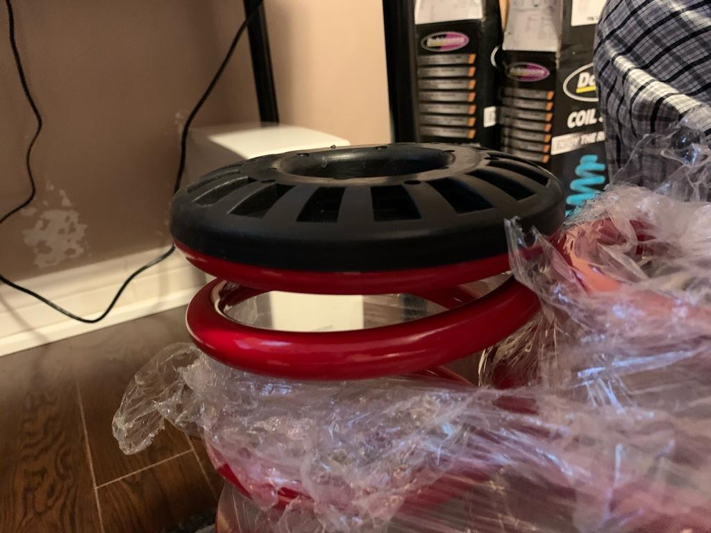

So im getting all my parts to do my rear air bag swap to coils. I ordered the Moog

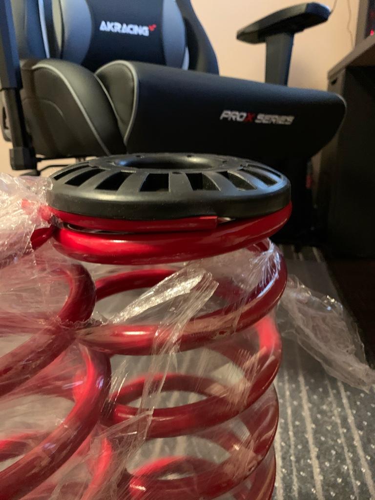

k160061 top spring isolators as mentioned by other people and also amazon, many seem to use them for their swaps on gx470. I received them today and tried to put them on my dobinsons rear springs, and it doesn’t seem to fully cover the top, i kind of have to stretch it over the coil and the end sticks out. Wanted to know if i could still use these to swap, really don’t want to dish out a lot for oem spring isolators.

I have had a DIY cut sheet of that high density plastic, 1/4" UHMW, for many years.
Super inexpensive, scraps from the local plastic guy. In my case.
Cut to to a round shape to match the top of the coil.
Even pulled them out a couple years ago, new airlift1000 install, still looked good.
