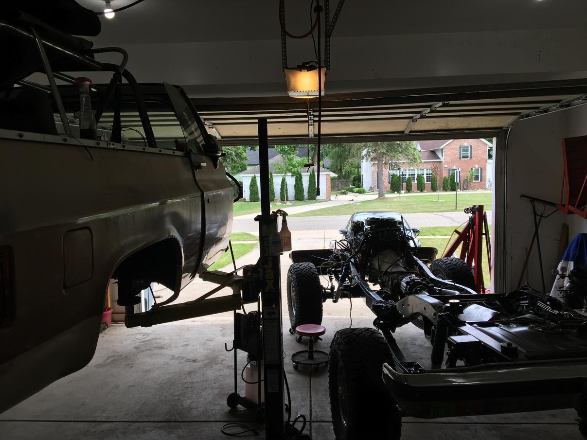

I can appreciate that it's not something most would tackle, but I'm the type of person that has never paid the dealer for anything more than mounting / balancing tires and alignments. I have a press, so I just need to buy or build the special tool.
Most recently I tackled a frame-off restoration on my K5 on a whim. I'm not afraid of projects like this, just need some feedback on whether the tools I'm looking at are the right ones.

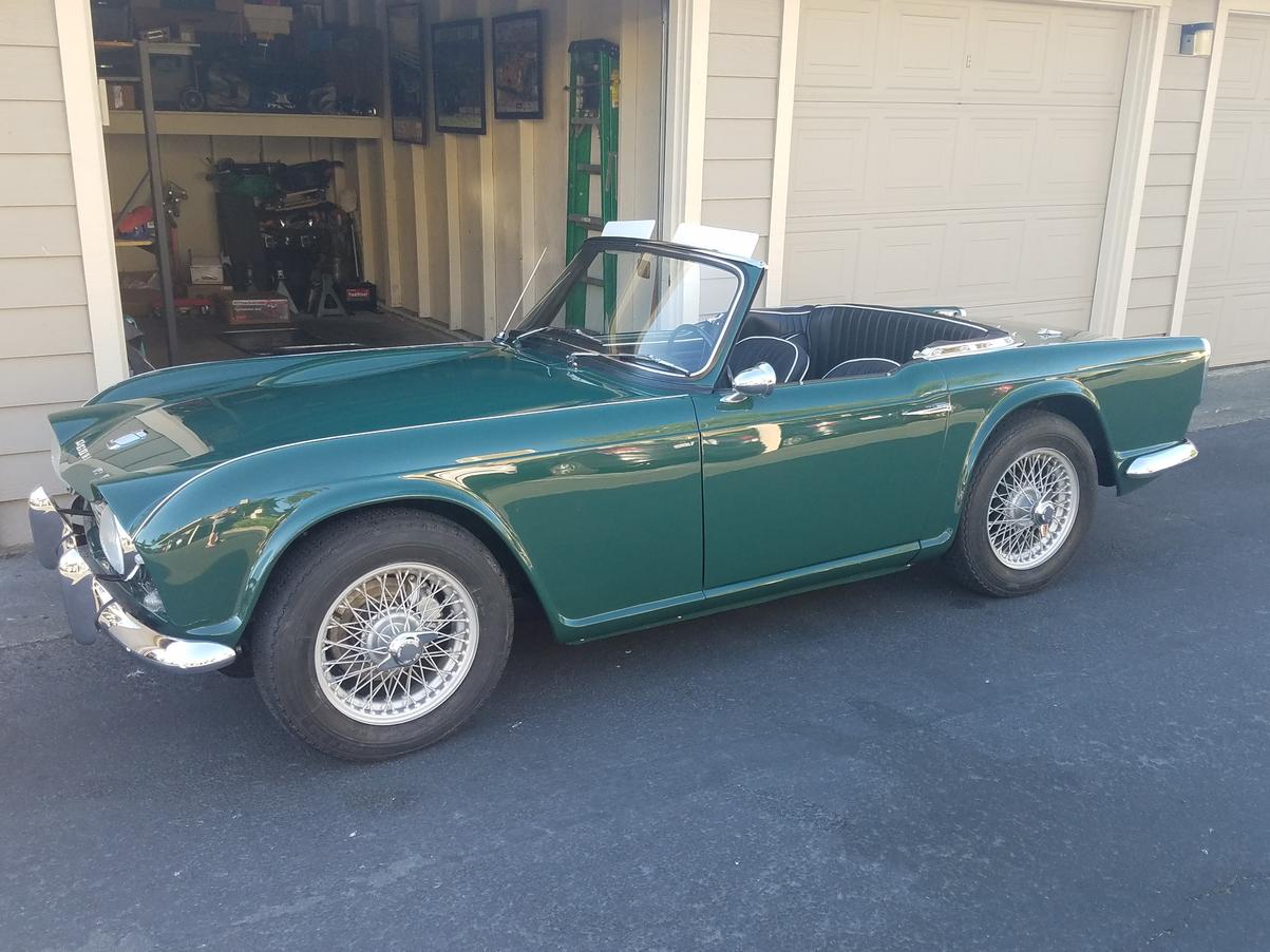

Nice project...mine was a 63 Triumph TR4 ground up/frame off/engine rebuild resto. Every nut and bolt replaced. Only thing I didn't do was bodywork and paint.
