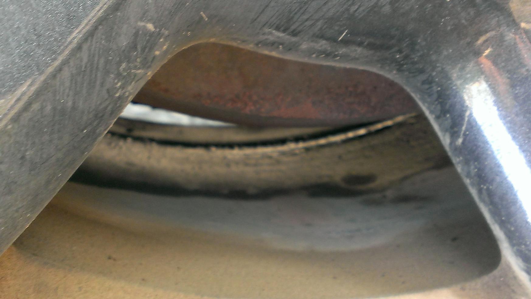

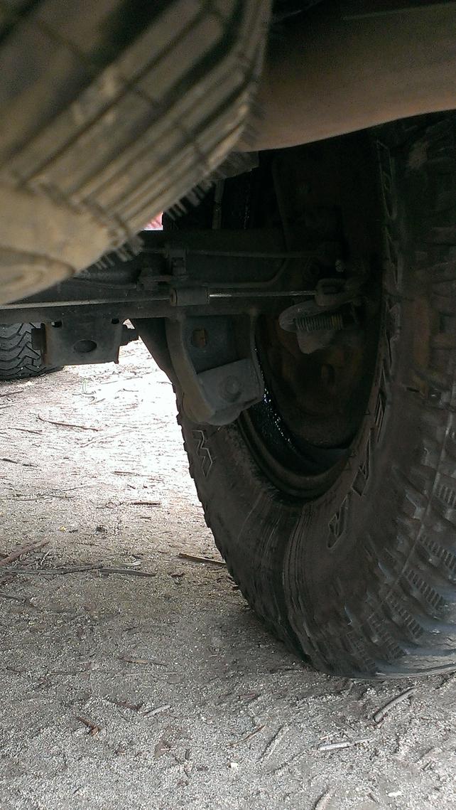

So I crawled under the rear of my 4runner and noticed what looked like grease inside the rear wheel and what looks like oil on the inside of the tire. What could it be (would search but I'm on my phone at a party so I'm trying to get a headstart on the repairs). Thanks in advance.

Rear axle seals.
Lots of good threads about this. A decent DIY can manage this but usually will have to get the bearing pressed on and off at a shop.
Do this fix soon as you are slowly draining your rear differential. Do both sides.
Make sure your breather valve on top of the rear differential is not plugged. This may have caused the problem by allowing increased pressure.
