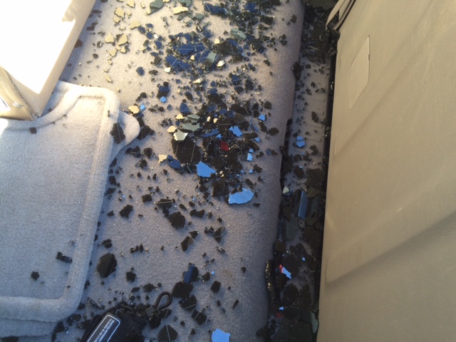

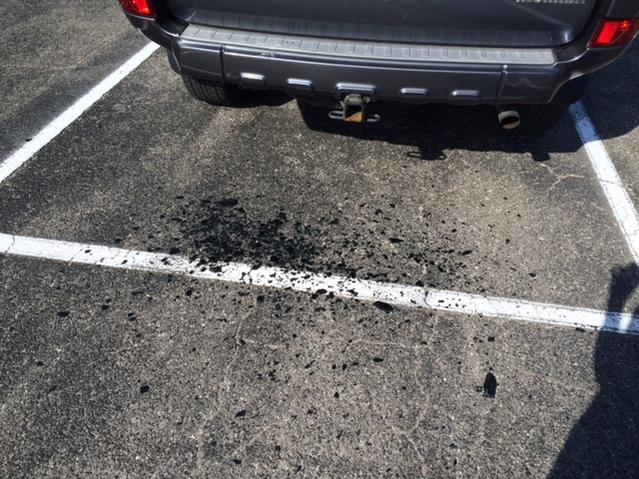

I get a call from my wife while at work, saying her rear window in her 05 4Runner was shattered. Upon investigation, there's no signs of forced entry. And glass both on the inside & outside of the truck.
A fellow employee that works in her building stated she heard it shatter but saw no one around. Basically shattered by itself!
To be on the safe side, filed a police report (for insurance reasons). Lee & Cates glass came out to replace it. They said the rear door latch doesn't work and had to gain access from the side. Advise my wife to take the 4Runner into a body shop & have them fix it, since the insurance deductible is already paid and should be included. My insurance concurred and advised the same.
Ok, does anyone have any idea how this happened, and why the rear hatch/door is disabled?
We live in Jacksonville, FL. It was mid 60's temp when it happened. Nothing out of the ordinary.
Thank you for any insight!
Jon

Looks like a lot more glass on the inside than outside. I'd look for a bb or pellet in the shrapnel. Maybe even a rock.

Same thing happened to me when my rear window shattered. Sometimes a piece of glass gets stuck in the jaw that closes around the latch. Not a big deal and the glass shop should have taken care of that when they cleaned out all the broken glass inside the hatch.

tempered glass doesnt like uneven heating elements.
I'm not sure what would cause the rear window - or any window, really - to spontaneously shatter while the car is parked, but it would stand to reason that if one of the defroster wires has been damaged, i.e. had the insulation scraped off while trying to remove a parking permit or other sticker, then I could see that causing a hot spot, which could cause the glass to shatter due to the ambient cold temperature and the uneven application of defrost heat.
Watch what happens to a bottle when you throw it in a bonfire and then pour water on it once it's heated up. That's what's happening to these windows, I suspect.
