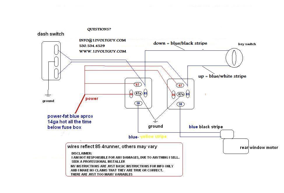

My neighbor had an issue with his runner and the switch not working. I grabbed the wiring diagram for a harness that the 12voltguy.com sells. Instead of buying his harness for $90, I made my own. It cost about $10 or less and can be made in a couple hours.

If you want your key and the switch to work you will need the relays. If you do not care about the key then you can just run the power wire to the middle of the switch and two wires from the outer poles on the switch to the window motor.

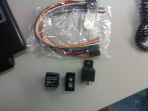

I don't have any part numbers. Just go to your local parts store and get a 30ft roll of 18 ga. wire, 1 3 position switch and two 30a 5 pole relays. Super easy if you're half decent with wiring.
Go to a stereo shop or best buy stereo section and ask the installers if you can buy a few of them. They will usually stock dozens of them for stereo or alarm installs. If you were local I would give you a couple, I usually have at least 10 of them in my electrical desk.
Just got these in the other day.. Gonna try and make a new harness and wiring for my rear power window. Hopefully the key will work as well. I will post pics and part numbers and total cost when I am done.. The switch fits in pretty decent..

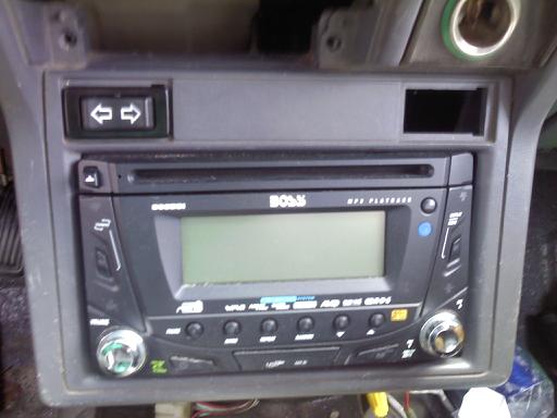

Did this mod and it worked great. I ordered all the parts from Parts Express.com and spent less than $20 for everything. I used their relays, relay sockets and momentary switch. This made everything super easy. Key and switch work and the ignition does not need to be on to use switch.
Sweet! Beats the heck out of a over prices $90 harness! I did this to my neighbors 4runner and it works out great!
Thankful for the diagram he has posted.. That to me would have been worth the $90!!! I went straight to the Batt instead of the t-tap. I figured the less points of splicing a constant power wire the better. This install took 30-40 minutes.
