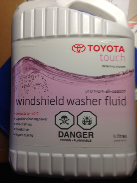

BTW, I always use this Toyota windshield washer fluid with protection down to -40 C.
