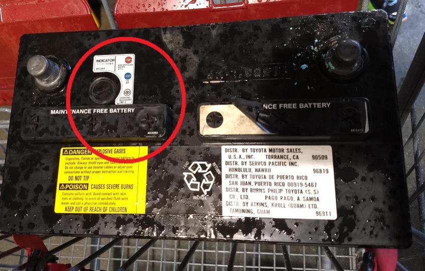

The indicator window on the battery was clear, which means "Charging Necessary" (see pic). I put the battery on a charger overnight but that didn't turn the indicator back to blue. So, I replaced the battery with an Interstate battery from Costco. Rear wiper no longer cycles when starting, and the driver door auto-down feature works after cycling window down and up.
