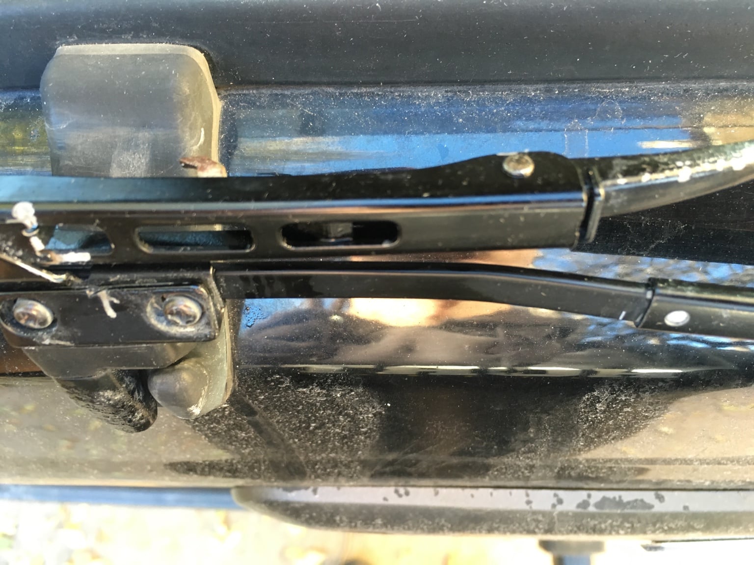

I would just add that it is key to do this while you have the blade removed. That way you can work the hinge PAST the point of blade contact with the glass. A lot of times you can lube the hinge up great but there is still very little pressure on the glass because the hinge has corroded right at the limit of contact, which is exactly where it needs to be free.
My original one never worked either. I determined the pivot point was corroded and no amount of penetrating oil would help. It seems the cast aluminum arm expands as it corrodes which tightens up the joint. My advice is to replace it with a used one that isn't corroded. Once you see how much spring pressure it should have it will make sense why it wasn't working properly.

Well, I hit the hinges with pb. Letting that soak. Is this bend normal?
