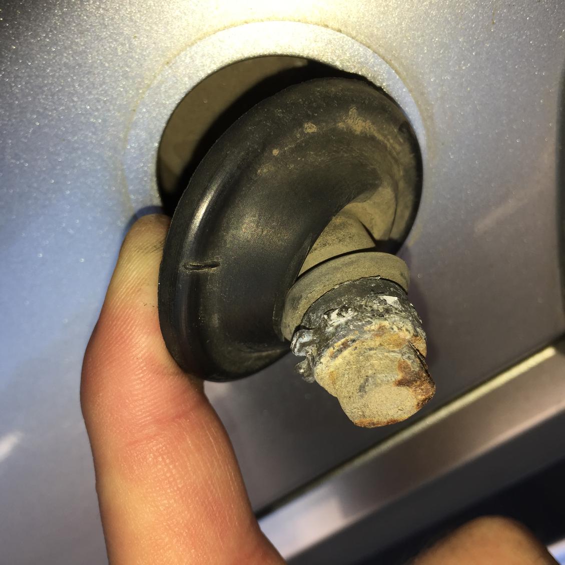

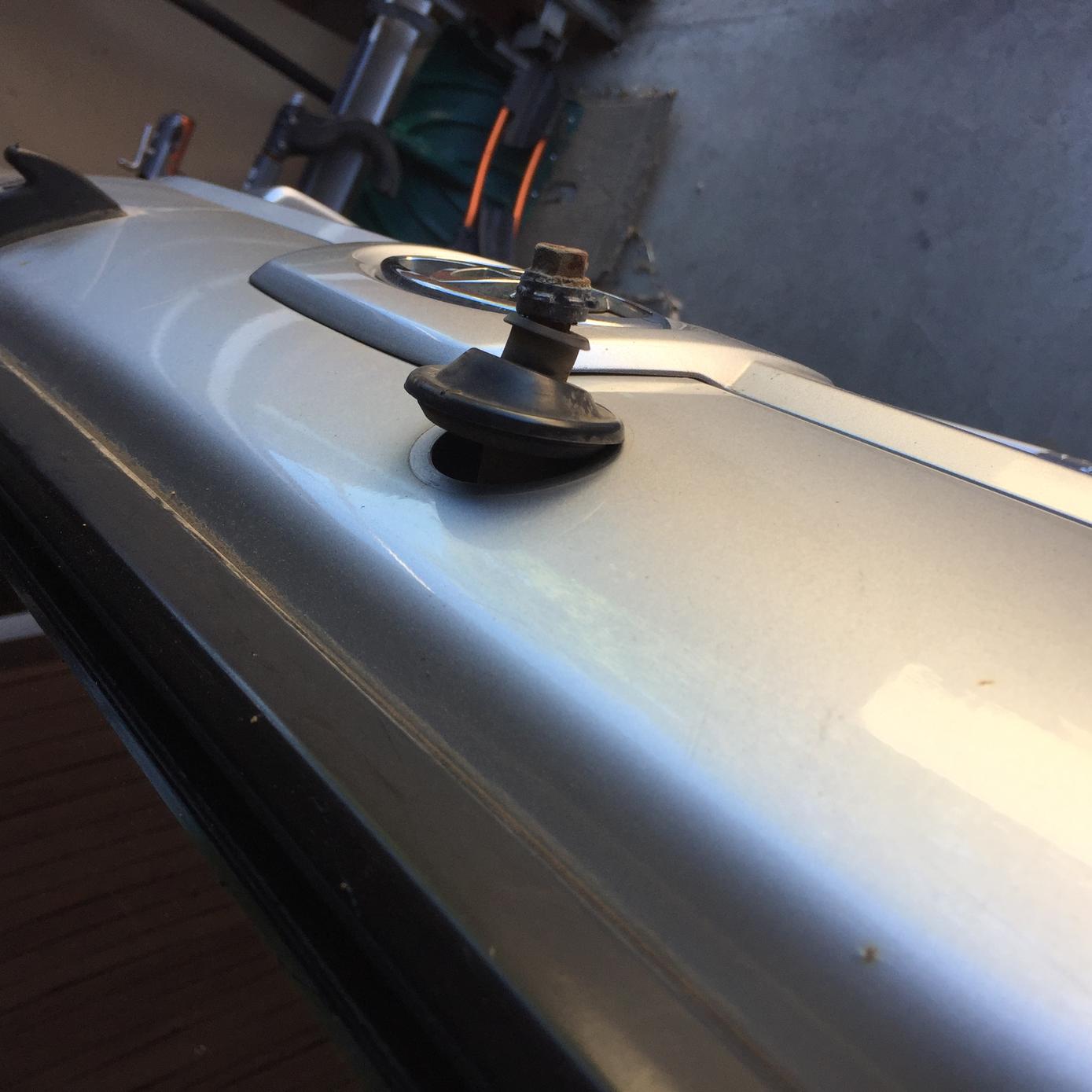

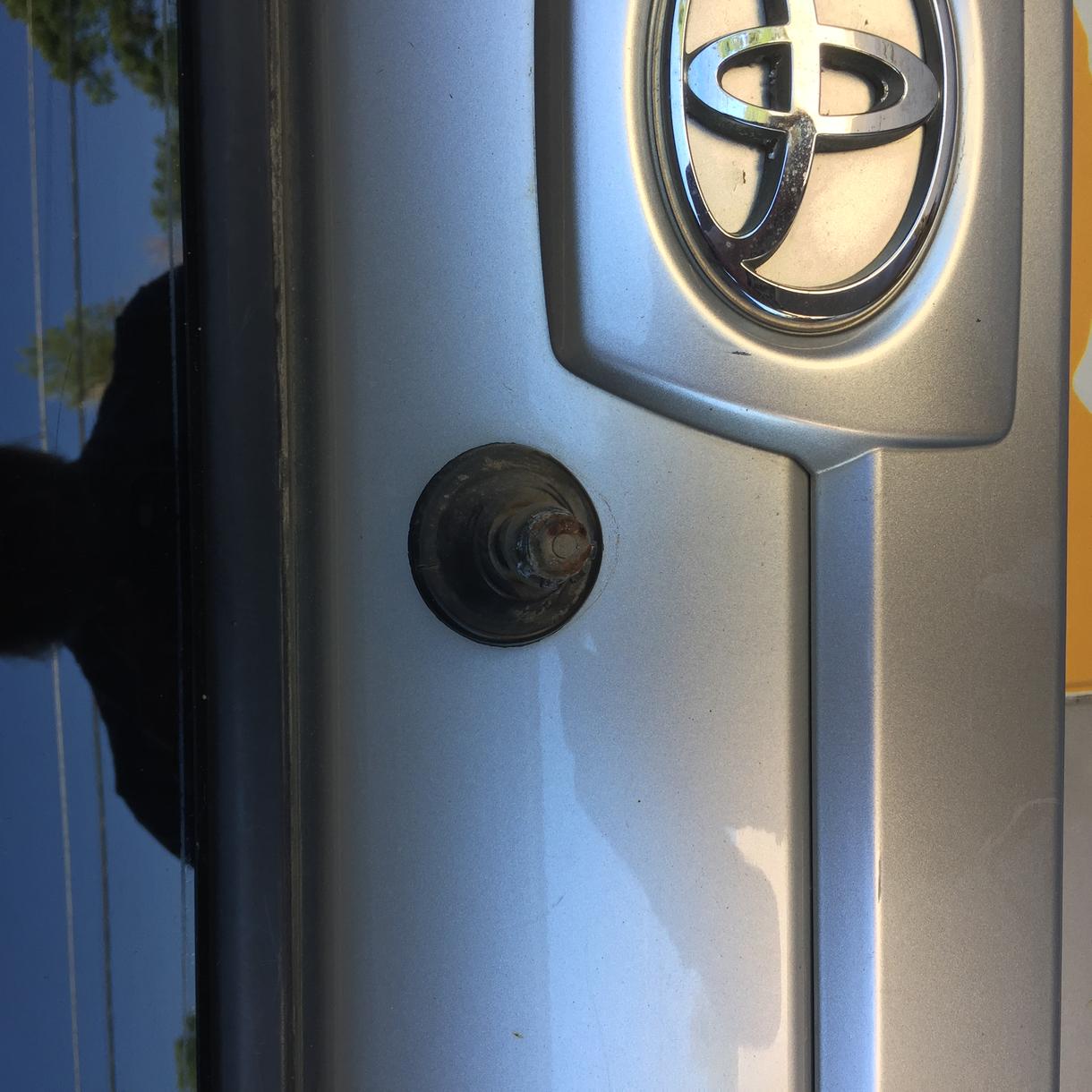

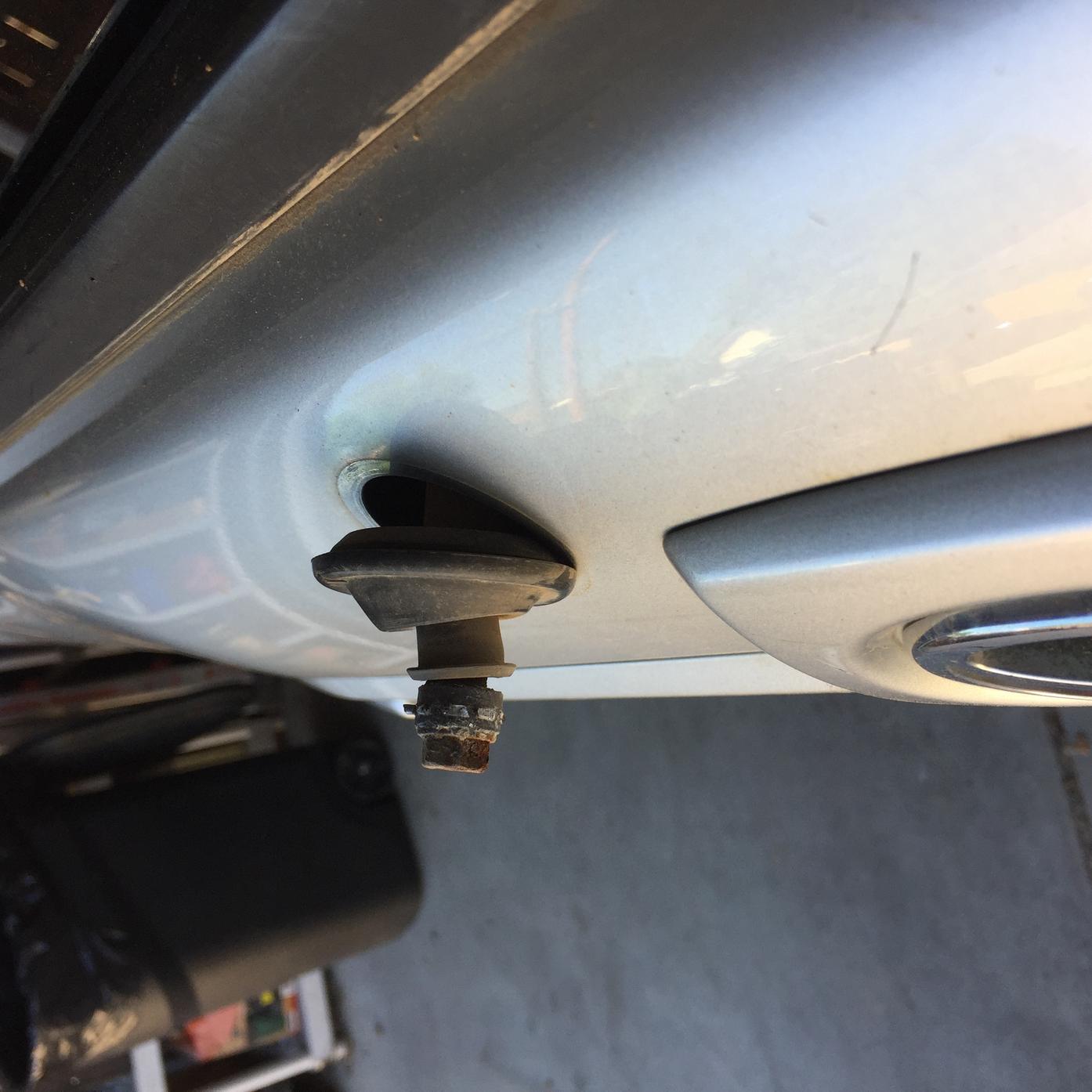

I ripped the rear wiper off the stud and the motor (or mounts) and gasket is/are now bent. How much of a PITA is it to replace all the parts (appx $300 on Amazon)? I'm guessing I'd have to take the window out to get to the motor.

I swapped out the rear wiper motor with a part-out. It’s pretty easy to access and take out through an access panel in the hatch door.

I did it with a friend and it took about 2 hours, it was really really easy. You just take the rear panel off the hatch, rip a hole in the plastic sheet and remove (3?) bolts IIRC.
When installing the new one, make sure to add some antiseize on the thread and install the arm so you wont have this trouble. Also, you may need to get the rubber grommet replaced as well as the old one may rip due to age.
