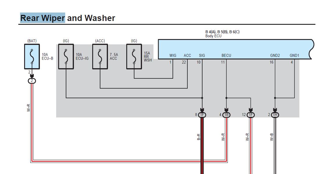

on the issue of not stopping, i read through a lot of the threads that i thought could be related.
- at first the rear window was sluggish, i dont know if that is normal. took a couple of seconds to respond to the down button. i read about the normalization and did it twice.
- wiper would keep running even when the rear wiper switch is off, it goes to home position when key is turned to off,
- battery is just past a year old. and its 97% capacity according to my battery tester so it cant be that.
- rear washer doesnt work. checking the fuses. i noticed that the 15A fuse for the RR WSH on the left hand of the steering wheel is missing the fuse.
i put one in and now the washer works. and i noticed the wiper stopped moving!
i tested it with the rear wiper switch and now it works normally!
my conclusion is that it needs all the fuses (shown below) to be working for it to be normal.
hope that helps.

DadBandBass I'm going through the same thing on my 2008 SR5. I was rear ended in May and had national body shop chain replace the entire back hatch. Everything was fine for a few months then the rear wiper started intermittently turning on when the car was fully off, exactly how you were describing. When I turn the car on sometimes the wiper stops, sometimes the wiper just keeps going, it had a mind of its own. I was able to temporarily stop the wiper by opening the rear window the smallest bit possible but kept looking for a solution.
Eventually my key fob stopped locking/unlocking the doors which pushed me over the edge and made me bring it back to the body shop where they replaced a module in the liftgate. I got it back today and everything was fine for a few hours but then my wife let me know the rear wiper was running while I was inside with the keys on my desk. Total kick to the balls.
Here's what I've tried so far. Over the past few months when this would happen I tried taking fuses out to see what stopped what and landed on these 3. POWER 30A which stops the rear wiper from moving but does so by killing the power wherever wiper is at that second, it does not settle back to its resting spot. When I would hear the clicking, removing RR WSH 15A stopped most of the clicking but not all of it. Removing ECU-IG 10A kills the rest of the clicking. Obviously not ideal but I'm trying to not have to buy a new battery and I can drive my wife's 2010 SR5 in the meantime.
I found a similar thread in a Land Cruiser forum (Rear Wiper Won't Shut Off | IH8MUD Forum) that eventually started talking about the ECU potentially being the problem. That coupled with the ECU-IG fuse needing to be pulled out to stop the clicking makes me want to go down that path. I have an aftermarket radio I put in myself and there's not a lot of space back there so I'm wondering if I'm pinching some wires to or from the ECU. Or maybe the ECU back there is kicked. I'll be honest though I'm not even sure which ECU is back there nor do I have the skills to look at electrical diagrams to figure it out. Either way I'm planning on taking the radio out for a bit and seeing if that has any effect.
