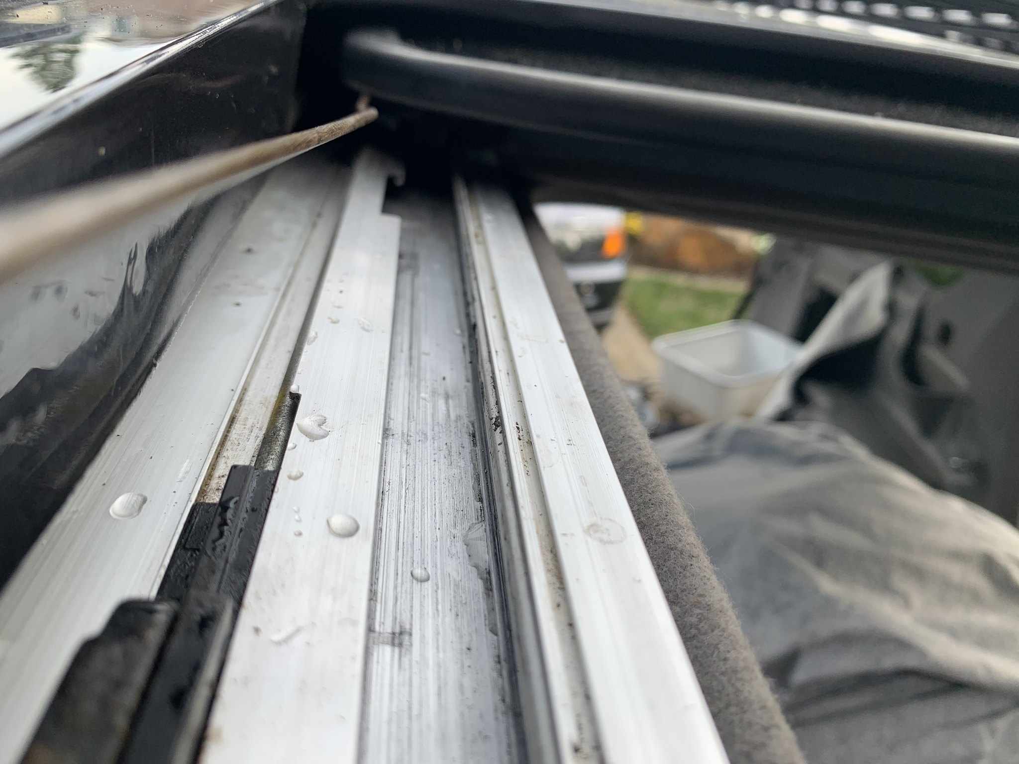

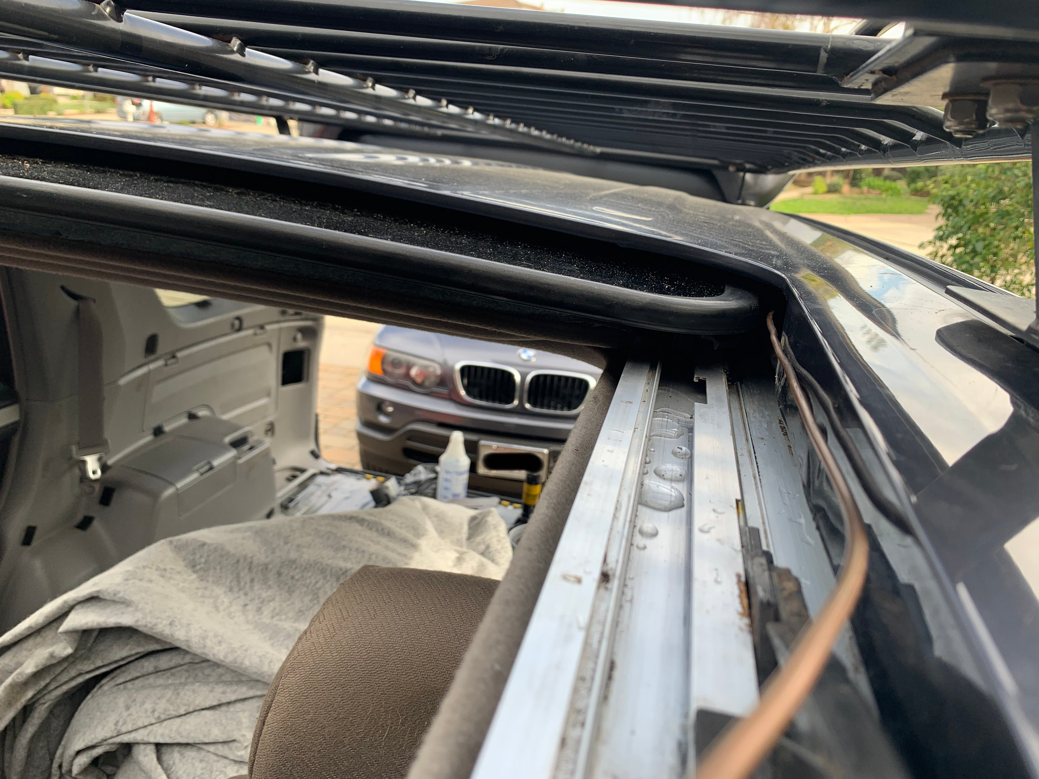

Cleaned out all 4 moonroof drains. Front were easy, but spent 2 days on the rear. Cleared the passenger side rear first removing the 2 interior panels to get better access to fish up the tube.
Trimmer line wasn't stiff enough, so switched to 12ga copper ground wire to get all the way to the moonroof to clear the tube.
Working on the driver side rear drain, I was able to access the upper rear drain hole with a straightened metal coat hanger. That was easier than fishing wire from the jack stand location. Lot's of redwood needles and debris came out.
Used a compressor to blow air through the line, then attached a wet vac at the rear end of the tube while pouring water from the moonroof. That worked to get the remaining crud out of the line.
Tried accessing the passenger side rear tube from the moon roof and clogged that line again. Used the wet vac, 12ga copper wire and compressor to get it clear again. It probably would have clogged up again if I hadn't done this. There was a lot more stuff coming out of the line this second time than what came out first.
