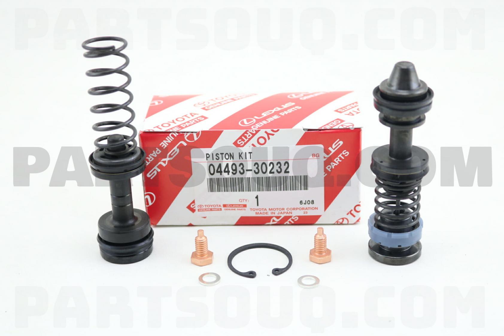

You can rebuild it. Seiken also makes repair kit for toyota.
There are two pistons in the brake master cylidner. There is a bolt on the side, that holds the inner piston, remove it along with the copper washer/gasket. Install new repair kit and then reinstall the bolt and then slide the 2nd piston. That's it.
Below is the kit for my 97 4unner:
thanks.
from the picture it looks like it does not have the seals that go between reservoir and body of master , those two add another 20 to the job that brings the price of kit and those two seals to $87. With NAPA current sale I can get a complete master with resevoir for 84. Of course how good is a new napa compared to a rebuilt yota one.....hmmm
