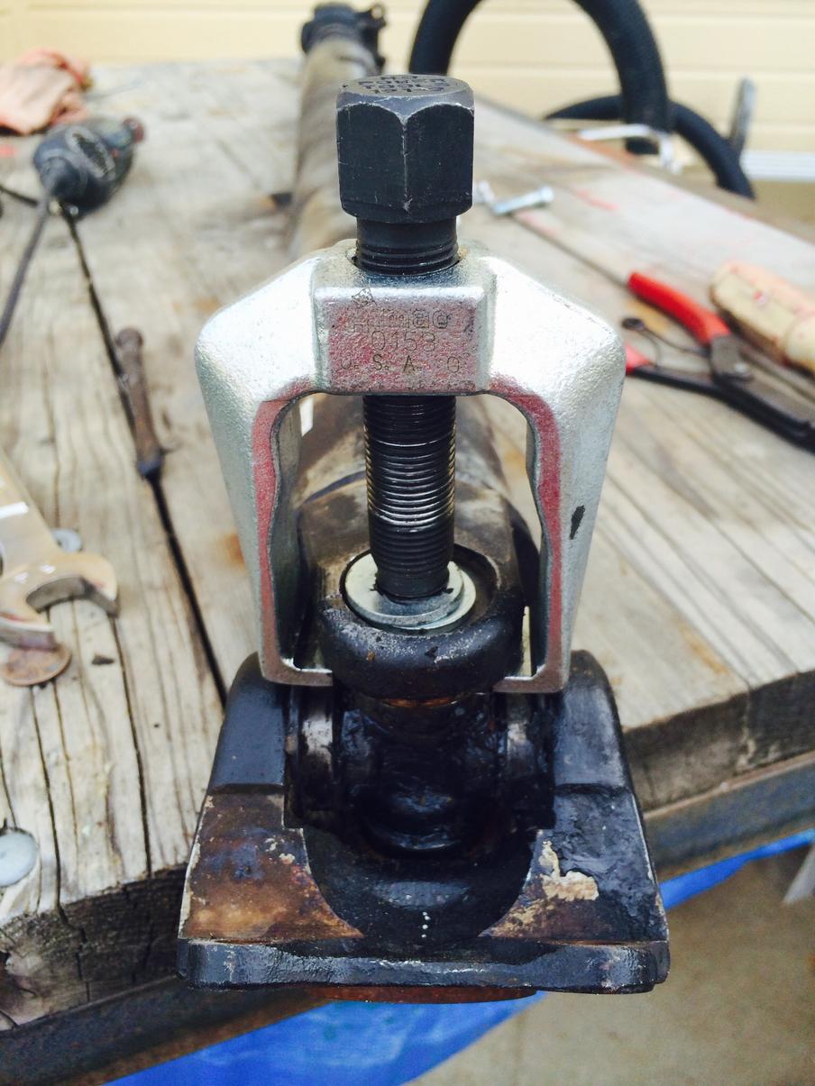

A wee pitman press came to the rescue yet again, enough umph to drive these low corrosion universal joints, making me very happy I declined to buy a $160 Tiger tool, a press purpose designed to extract u-joints. Wrong side of Rockies corrosion very possibly could defeat this pitman tool press. Actually with the outrageous quotes I was getting to replace the universal joints, the Tiger tool would have been a better-than-breakeven yet spendy proposition.

Conceptually ujoint removal is pretty simple; chisel off the circlips inside the yoke, press the joint one direction to shove & remove the opposite cap outwardly, then press the joint back in the opposite direction to remove the second cap. Minus the two caps, the cross has wiggle enough to slip out from the yoke. Repeat 90°, and dismantlery accompli.

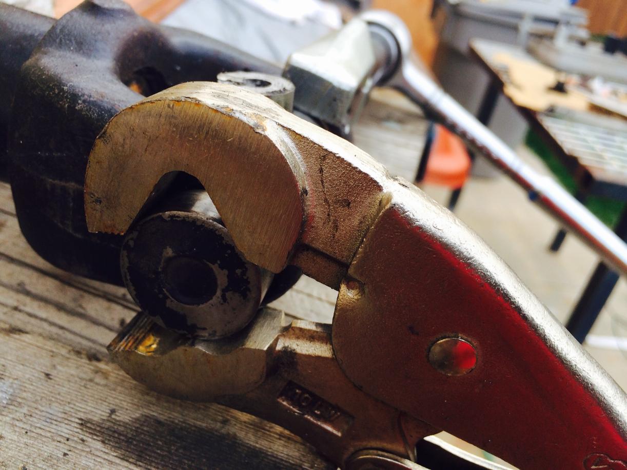

The problem on my shaft; before the first cap would fall out, the shoulder of the cross ran into the inner face of the yoke, preventing further pressing. I have some killer vice grips (pipe holder style) that grabbed the the hard & sturdy cap well enough, but I held back gripping the cap, & hammer tapping on the vice grips slid them off & left cap behind. I wasn't ready to go full hulk on it (worried about deforming the caps in the process) in case I had to press it back the other way and not wanting to ruin a yoke with a damaged cap. I'm a big fan would not dorking parts during a repair... [ed note - Toyota FSM says push a cap out enough to get a grip on it, clamp the cap in a vice and tap the shaft off. Lesson learned)
My solution, was to work it apart just enough to get a cut-off wheel /die grinder (and later a full fledged cut-off saw for certain angles) , in order to cut off one arm of the cross while still in the yoke, shortening it enough then work to joint back the opposite direction not much, to work that out. a damn PITA.
In retrospect, if I had just run on with the SuperVice grips , to sic on the exposed cap and beat it out, could probably skip the sawing, but this time it was spare the yoke and spoil the abrasives.... but next time ...

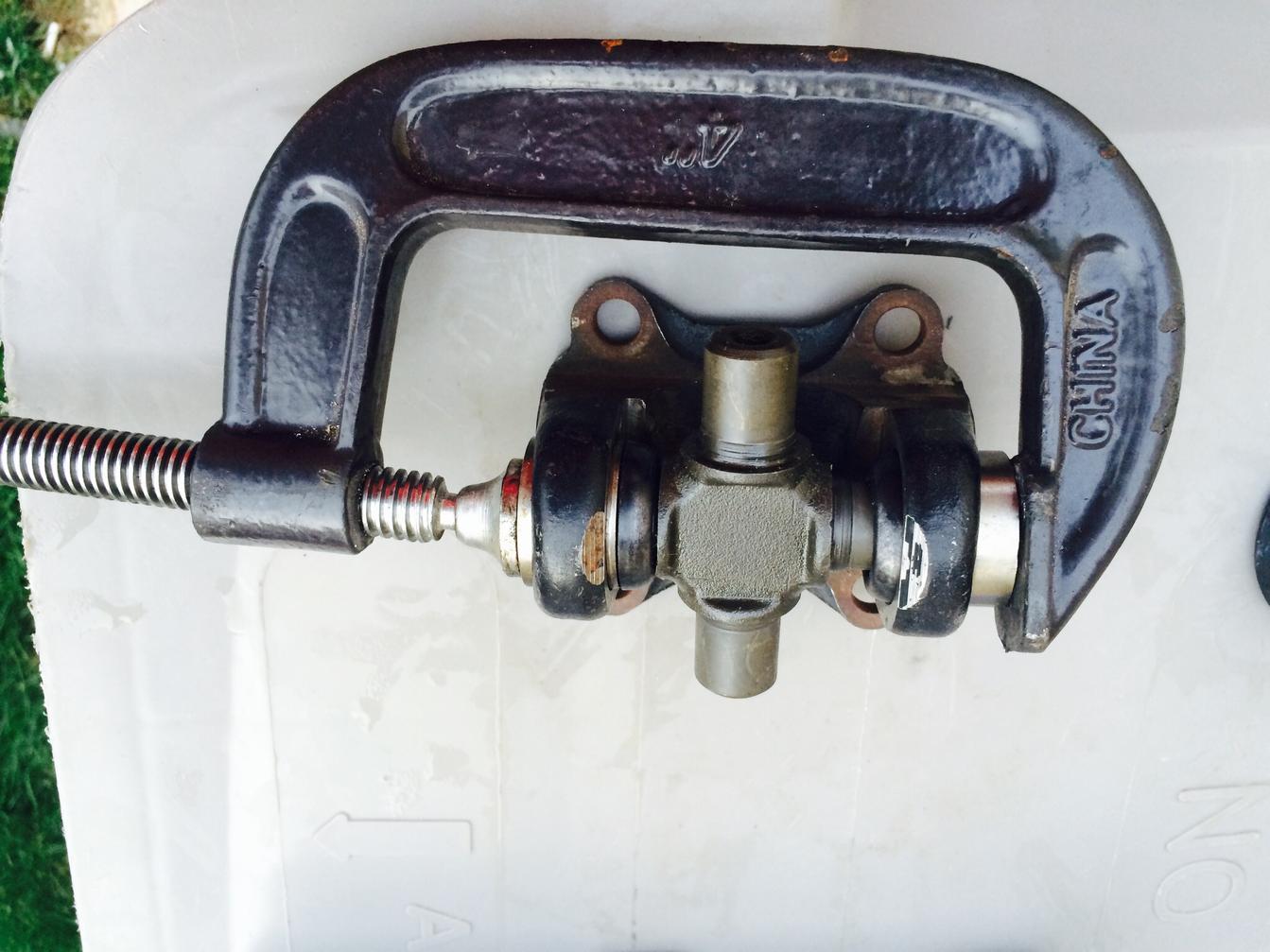

I first used a kind of a Scotch-Brite dremel buff to clean the bores on the yoke, allowing the new caps to slide in nice. And easy. Just like Tina Turner said.
I took all four bearing caps off the central cross of the new universal, wiped the cross free of grease so it would pick up less dirt, help the cross in the yoke and started both caps from the outside, then a simple but hefty C clamp was strong enough to drive them in. C-Clamp both caps at once, one cap is bound to move further inward than the other, install it's circlip, then press the second one against that stop, to get its circlip on.
