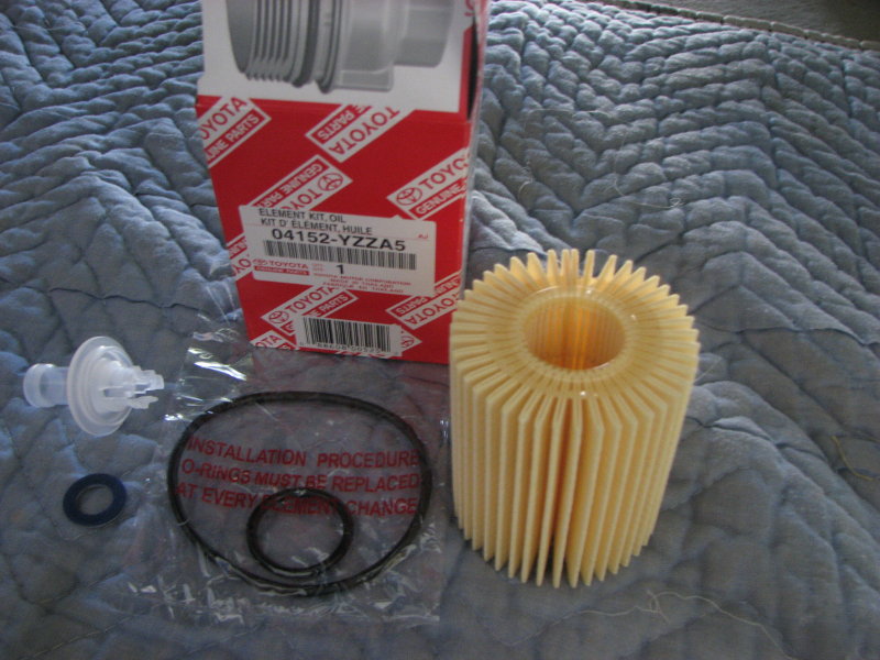

Someone asked for pics so I took a few.
Start with a new crush washer (for the drain plug) and filter, (comes with the 2 o-rings and the drain tube).
- 6.6 quarts Toyota 0W-20 oil
- Toyota filter kit # 04152-YZZA5
- Toyota oil drain plug gasket (part # 90430-12031) get these on Amazon or the dealer
- Large drain pan
- Funnel
- 64mm filter wrench
- 3/8" drive ratchet, extension and 10mm, 12mm, & 14mm sockets

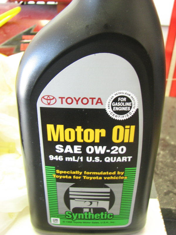

Bought a case of this for a little under 7 bucks a can. List was 9 something. Crazy.

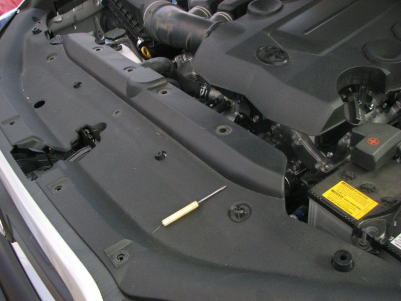

I took off 5 covers but the top 2 were just for looking around.
The "Upper radiator support seal" has 12 plactic clips. I used my fingernail and a small flat blade to get them out. Push down and they pop up.
