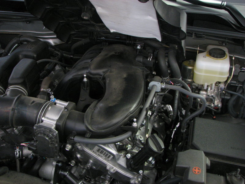

I also took off the top engine cover. It's easy, pull up and forward.

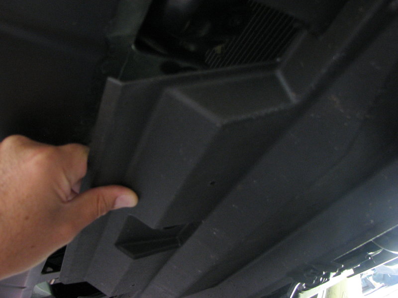

The lower bumper cover is 5 bolts and a clip. Taking this cover off makes the front engine cover easy to remove without raising the car.

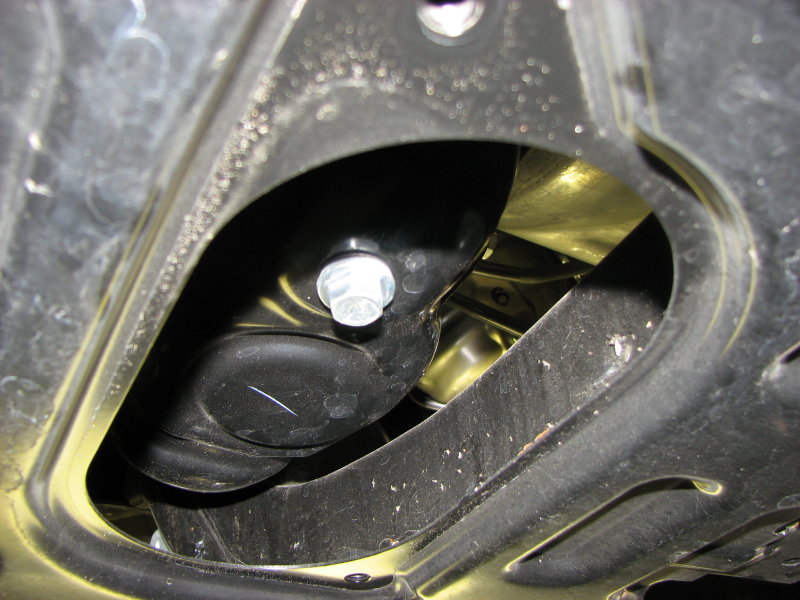

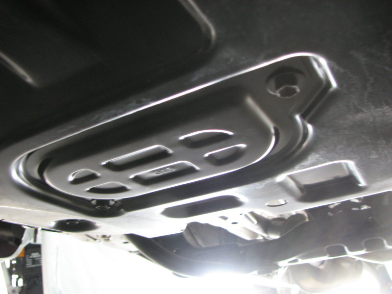

This is the oil drain plug cover. 2 bolts. The oil drain plug (14mm) is right inside, can't miss it. After I start the draining I remove the oil filler cap to help with flow.

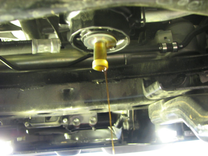

I drained the sump oil completely and reinstalled the plug with the new crush washer before I tackled the filter asy. 30ft/lb for those with a torque wrench.

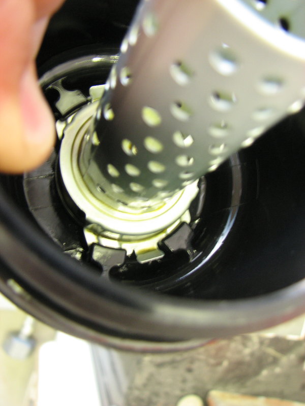

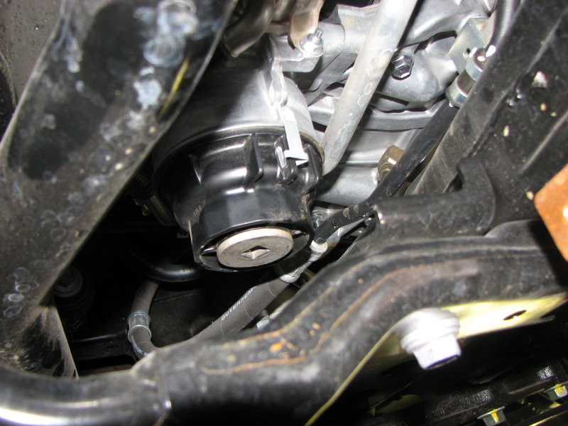

Here's a pic of the filter asy. Remove the plug with a 3/8" socket ext. I had to hold the black plastic housing at first to keep it from loosening with the plug. A little oil will come out. Use the little plastic tube and jam it all the way in to release the rest of the oil.
After all the oil is drained, take out the clear tube and o-ring by pulling off to the side. Now spin the black plastic housing off slowly using a 65mm filter wrench. The little silver clip doesn't need to be bent out of the way.

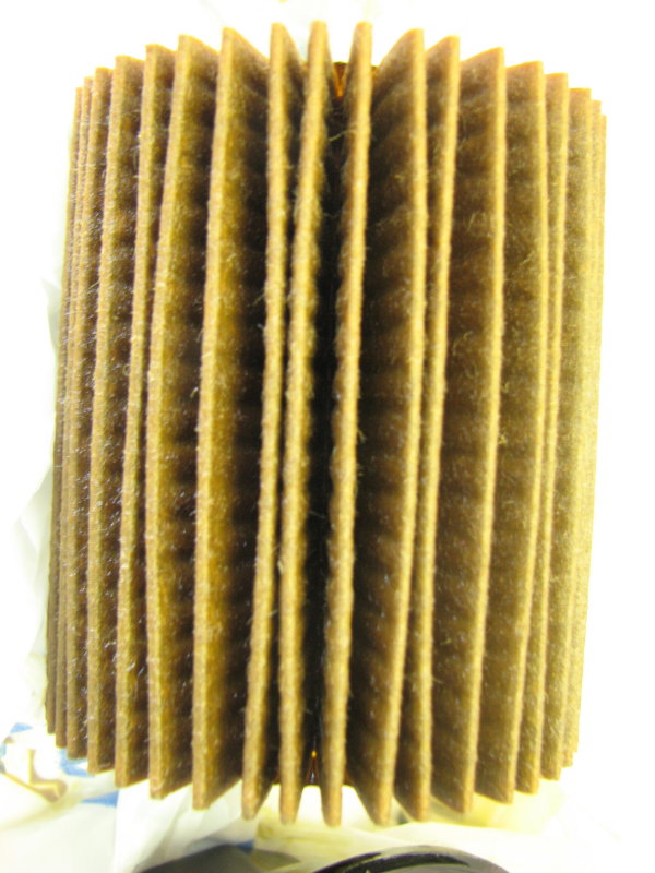

Only 2039 miles and this oil looks and smells really clean. A very small amt of metal in the bottom of the filter.
Put it all back together with the new, oiled o-rings. Torque ratings are on the filter box. I put in 6 qts of oil, started the engine, checked for leaks, let it sit for a few, checked the level and added a little less than 1/2 qt. Perfect. Put all the covers back on and I'm ready for action.
