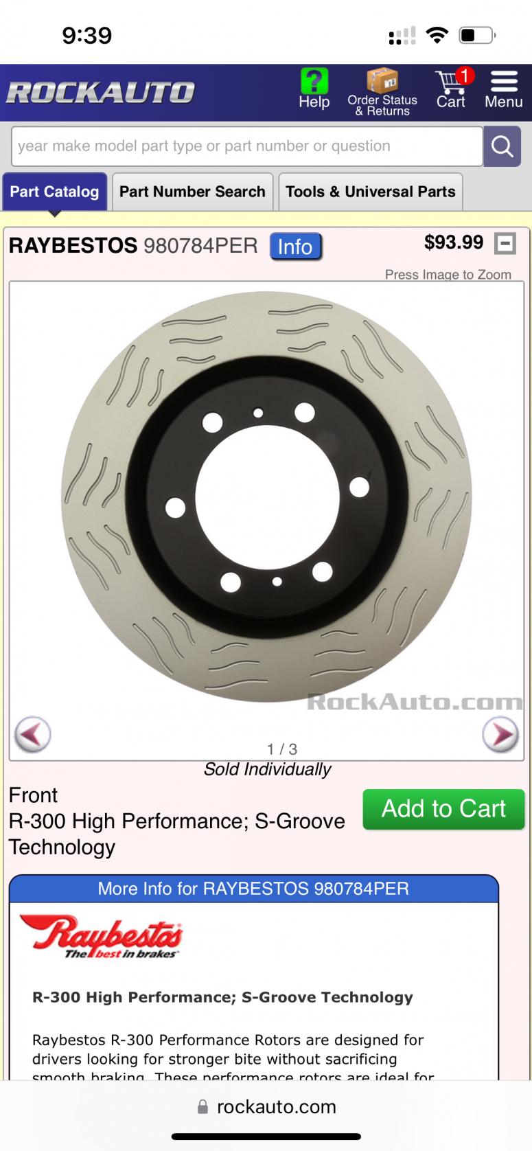

Raybestos R-300 slotted is all I use. Never had them warp.
